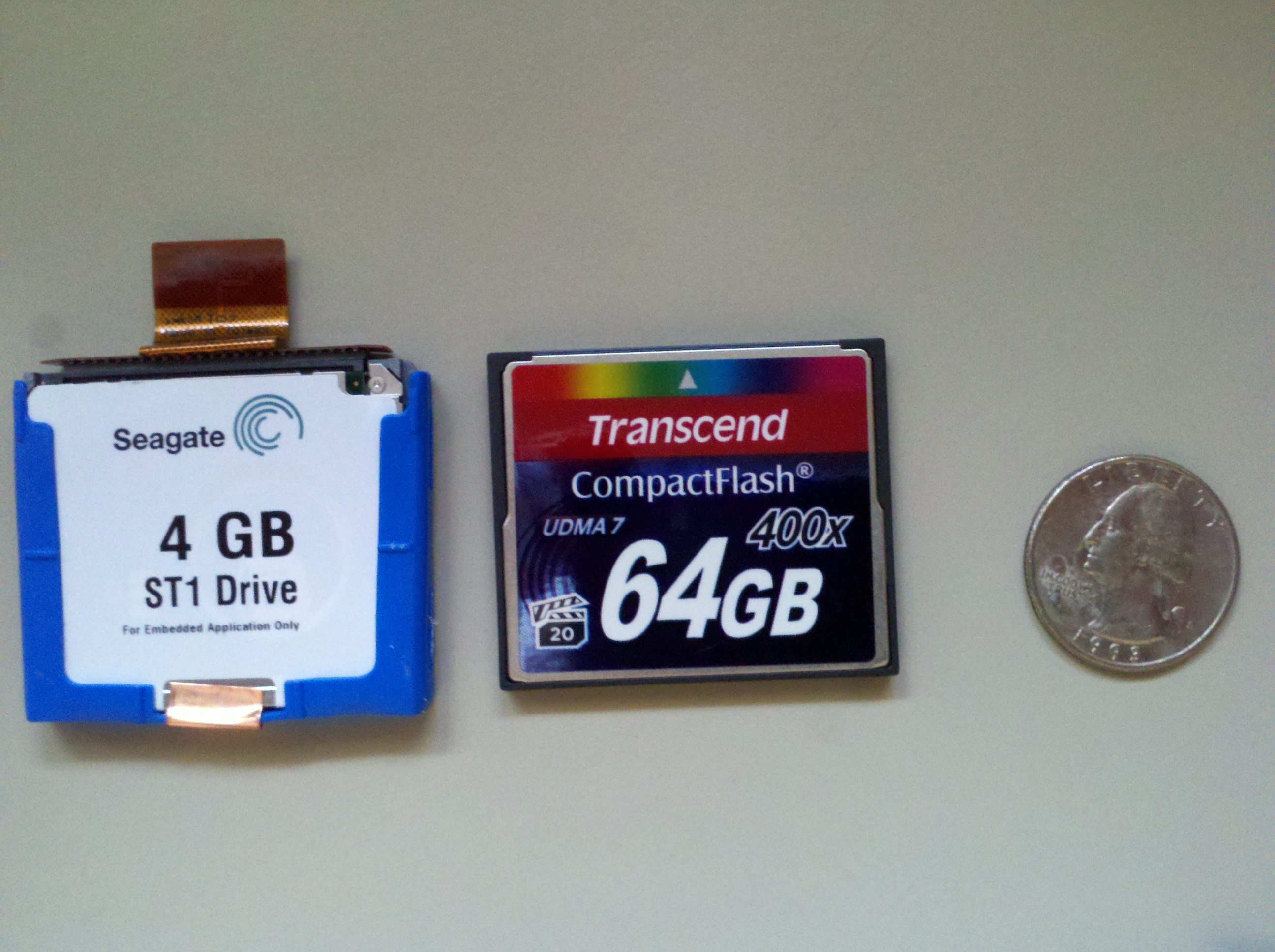

So within the next week I shall acquire a deep blue 4GB iPod mini. I've always loved that model for some reason. Anyway, I'm going to be gutting it and replacing the battery and the microdrive with a cf card. It is probably going to be a 32 GB, since those are reasonably priced. The 128 GB cf card is way too expensive, but I may end up buying a 64. Not totally sure yet.

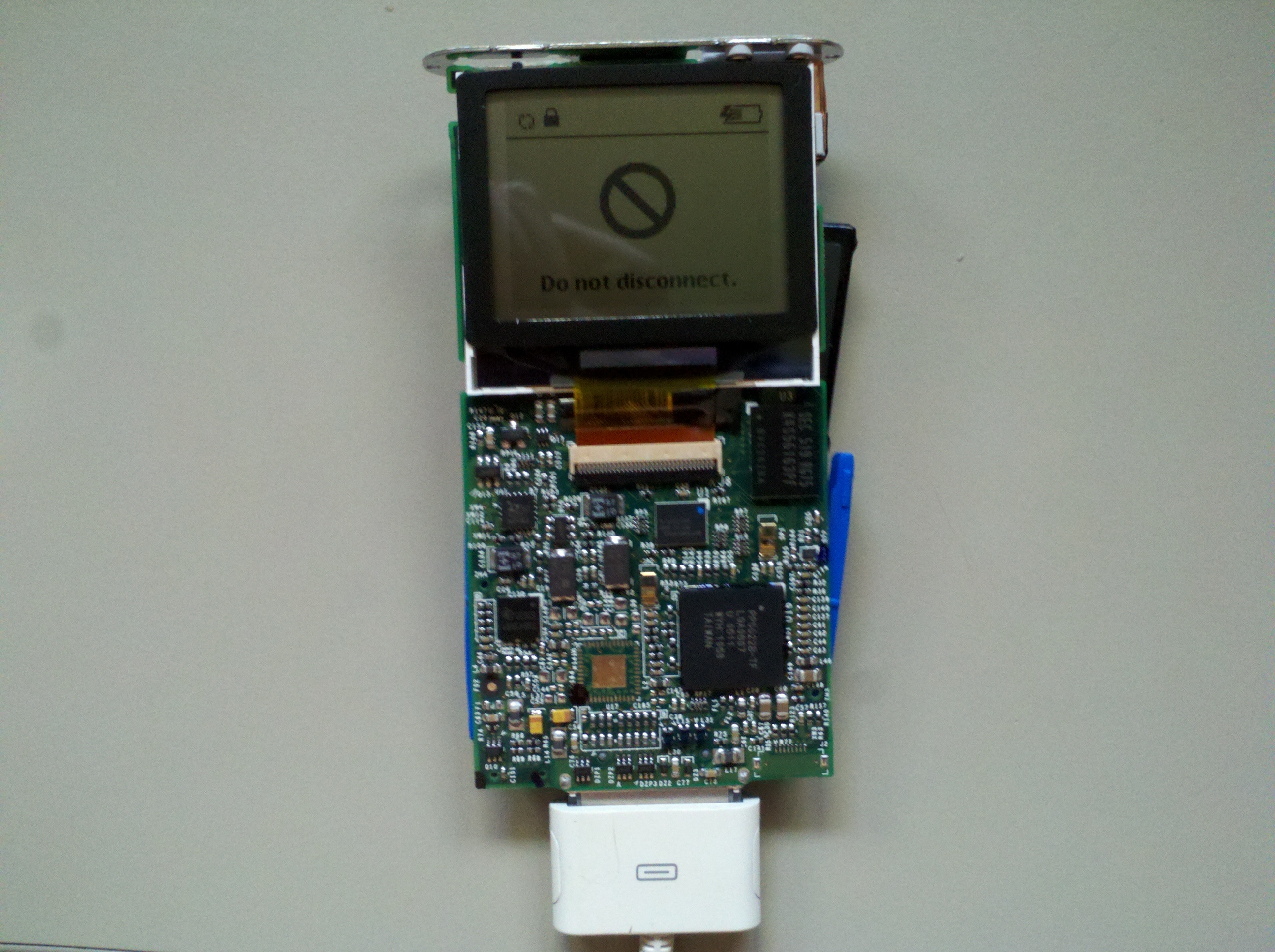

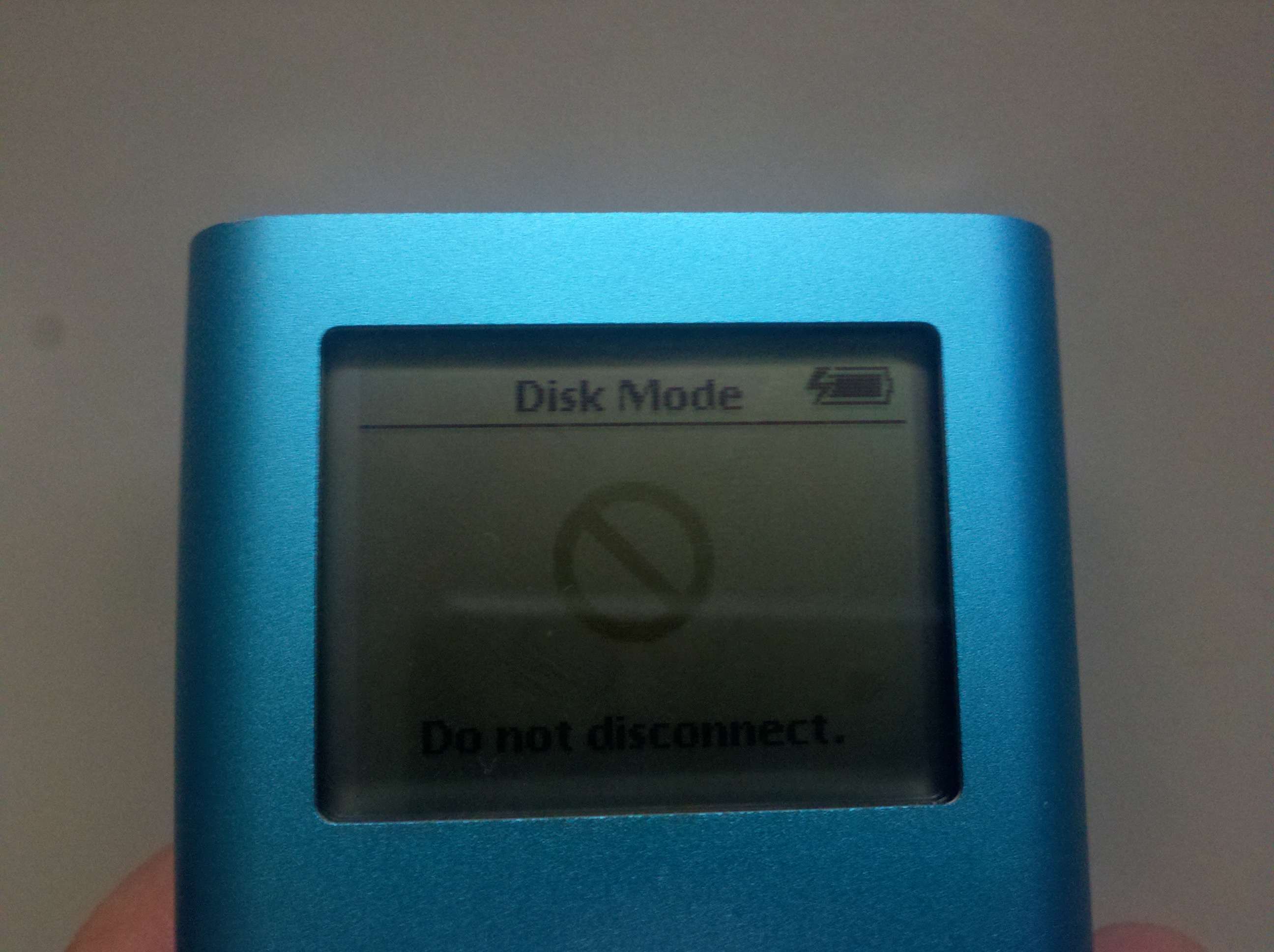

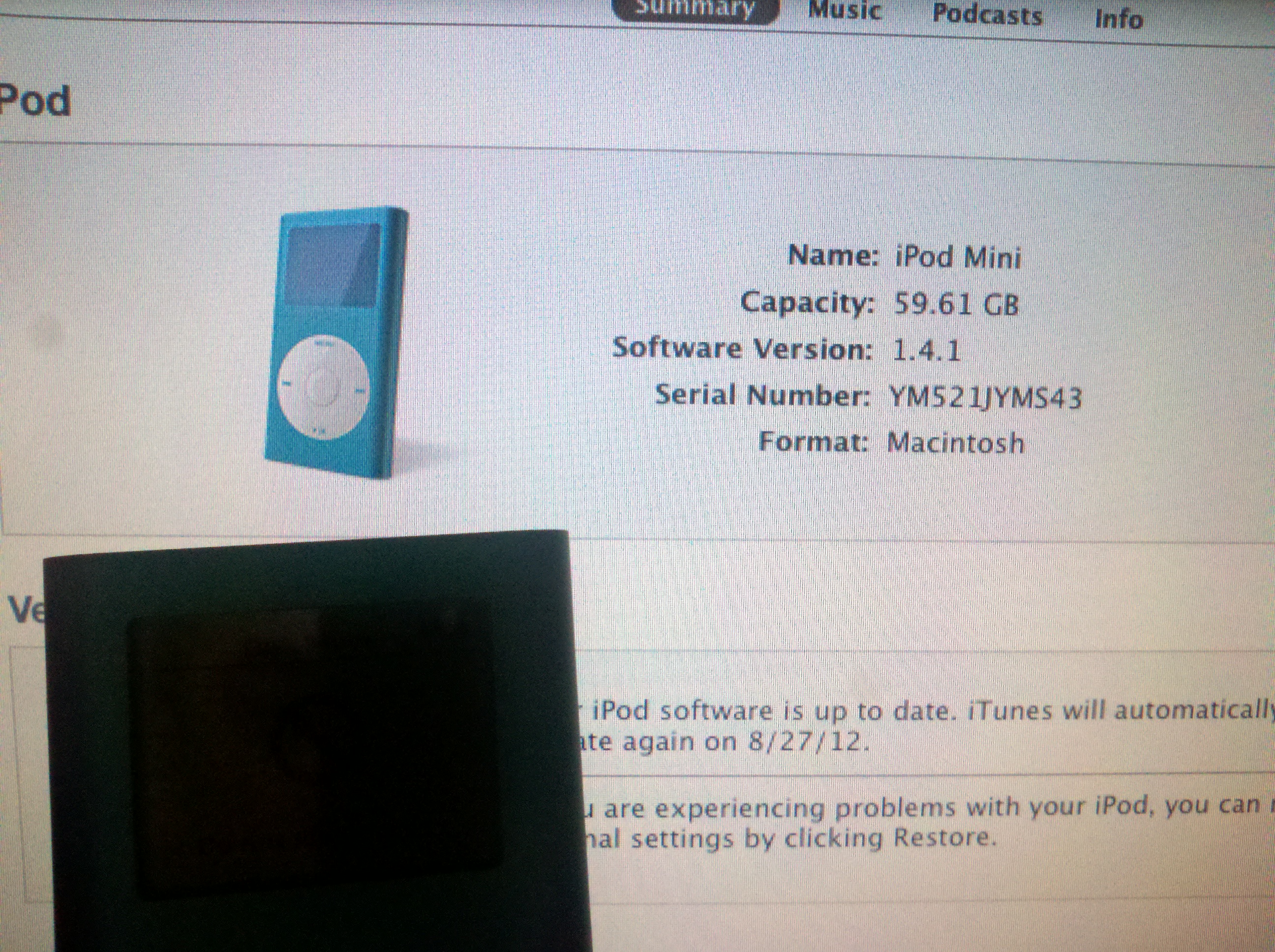

So I put a 64 gb card in, and the iPod restored. The UI works fine and I can access everything, however, the iPod mini OS freezes after being plugged into a computer (windows and Mac OS X). I have to then restart it, and this repeats. I've tried multiple restores.
Any ideas?
I figured it out! It needs to be put in disk mode in order to sync. It works perfectly and the write speed is phenomenal. Pictures will be up soon!
So I have to sync it in disk mode, but it works just great! The new battery works well too.
I'm still amazed at the microdrive...I think it's pretty cool so it's going in my bin of cool obsolete technology, right beside the Quantum Bigfoot 🙂
