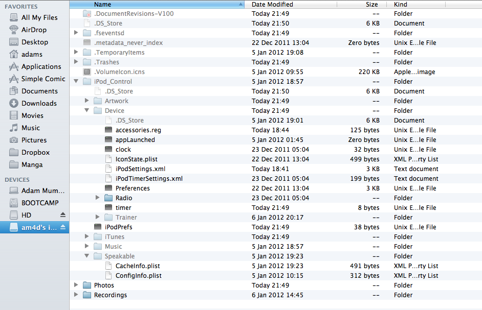

The command does nothing visible in terminal, but once you relaunch finder (alt+cmd+esc to bring up force quit menu) it should show hidden files as you see in this screenshot. Grey files are usually hidden.

I've got those setting up now. turned mac on tonight and all those hidden files were there. ..so ye managed to find the volume limit - mine was 216, set & saved as 256. just rebooted iPod...hopefully settings have saved now.
