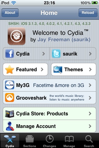

thats what im telling you, the blobs are mine, and they are related to this device only, and i have blobs from 3.1.3 to 4.3.3 for this device, so is it possible to downgrade using them or not, if not then thanks for your lousy answer. anyone else have a better comment.
See the picture from Cydia about this device..
As you can clearly see above, i have a lot of blobs saved for this device, but how do i get down from IOS 5 to IOS 4.3.x? I tried searching, but out of luck.
This is an iPod Touch 3G, i want to be able to downgrade this to like 4.3.3 or maybe 4.3.5 first, then 4.3.3 or anything else but the IOS 5..
Please, im not a noob, i know my way around, but this is my first iPod tho, so can anyone please give me a step by step in order to downgrade this iPod Touch 3G?
Going to ***BUMP*** this once, and see if anyone is smart enough to post a serious step by step guide in howto downgrade this thing from IOS 5 to either 4.3.3 or 4.3, no matter, i have shsh for this device stored and they are from 3.1.3 and up to 4.3.3. Look at my picture and see for yourself.
So, any chance to downgrade this? And how do i do it?????
