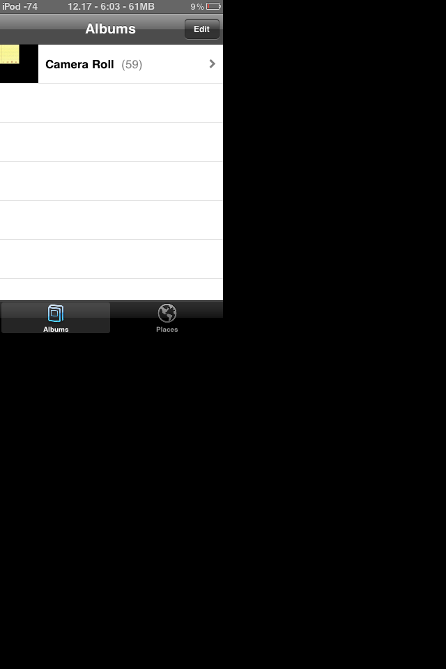

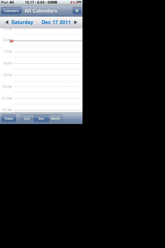

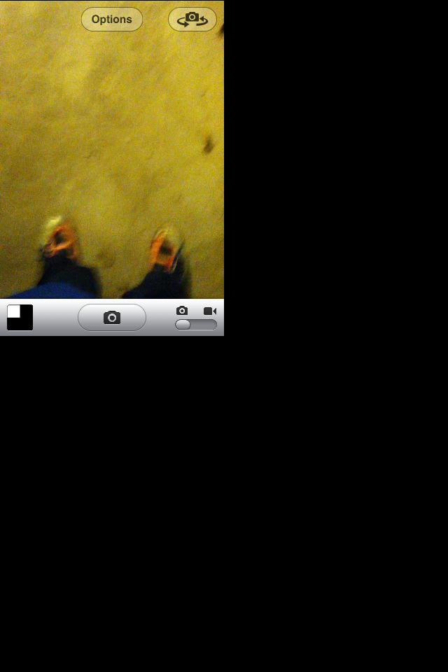

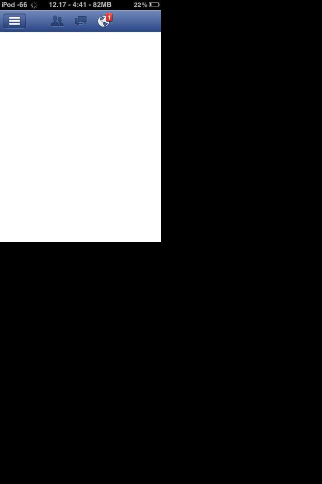

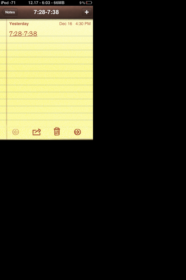

so i have an iPod Touch 4th gen with ios 5.0.1 and did a tethered jailbreak and installed semitether as well.(redsn0w 0.9.9b8) and it worked fine for a while, but now when i boot tethered, the apps open only on the left side and are small(like only take up a quarter of the screen in the top left, i will link to pics). the rest of the screen is black, and does not seen to do anything when i touch the black area, but it does respond when i touch the area where the app is. also, i did notice that when i reboot without booting tethered, it all works fine. i would say it is probably an app i installed from cydia, but i have not installed any more recently. I would just back it up in itunes and restore it, but i would have to get all my cydia apps back, and i would back up the apps with xbackup or pkg backup, but i cant use any apps right now. so restoring is kinda a last resort, but i think it may come down to that.

One of your Cydia items is preventing the iPod from using its screen in Retina mode. Remove them one at a time until you have found the offending item.

Start up in Safe Mode and access Cydia. I forget how to get into Safe Mode via SSH. Try using Google.
thanks
edit: i was able to get into safe mode from sbsettings.
thank you. i googled it and unistalled a few apps. i will post back what happens. again, you are amazing.
THANK YOU!! you are an amazing person and i dont even know you! thanks you!! i am very happy i didnt have to restore.😀😀😀😀😀😀😀😀
question
so this happened again, and i went and uninstalled another app. i have noticed this happens every time my ipod dies. also i noticed after this happened a few times, i could just go into cydia in safe mode and it fixed it, i didnt even have to uninstall anything. i have not tested if just going into safe mode fixes it, but it has not died recently and i have not had enough time to see. i will post back if just going into safe mode fixes it soon.
