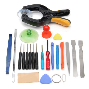

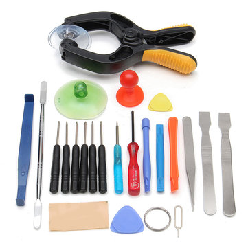

You might need a small suction cup to pull up the screen, or a clamp with suction cups. Also, its good to have a business card to slice the glue (avoid the top where the cable is) and some plastic pry tools to disconnect the digitizer cable. Go gently, and don't force anything. And if you remove any screws then put them on a page and label them.
Some common tools:

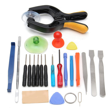

Some common tools:
