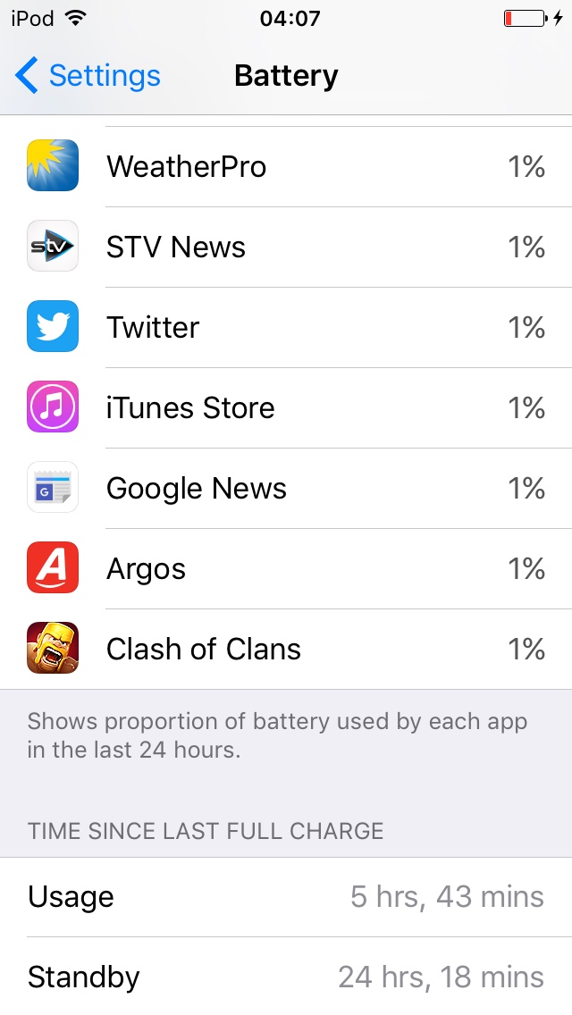

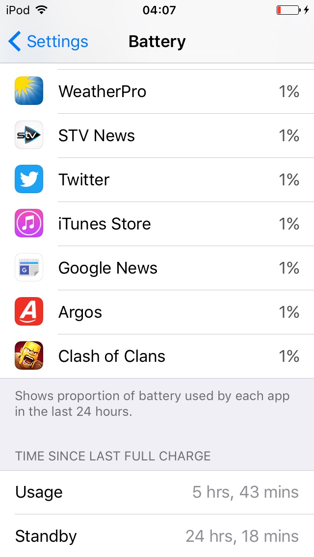

What sort of battery life are you getting? The charge after I got 6hrs usage with a reading of 12% remaining.
Here is mine with 69% battery remaining: This is my second iPod Touch 6th Gen. as the first proved to be a lemon battery wise. Bought in July last year, the battery quickly became worse and the Genius couldn't say why. Unlikely to be a rogue app as I have so few apps, but the Edinburgh store replaced mine in December without question.
I've never had battery issues on this one, only turn on wi-fi when I need it for apps like Wiki or News, but I don't play games or watch videos on it - prefer my iPad Mini 4 for that.
