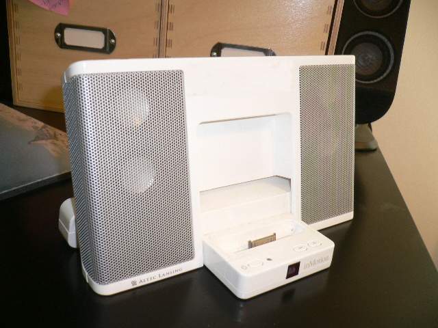

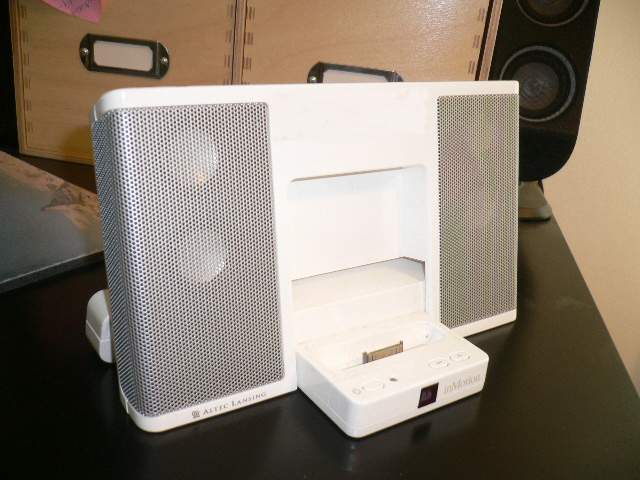

Hmm. I'm pretty sure those are the same speakers I have (I guess there might be more than one style of "older" inMotion speakers), and it's not working. The pins seem to fit easily and securely, but the music still comes out of the Touch "speaker" and not the real ones. Any hints?
I have to actually hold the iPod Touch straight in the dock or it won't work as I don't have the adapter to make it sit in there properly.
It's not a good idea to let it just flop around or the connector may get damaged.
I also get the pop-up message saying that 'charging is not supported with this accessory'

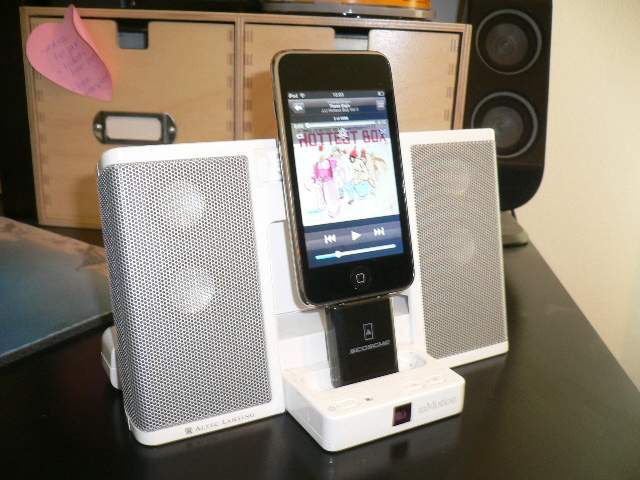

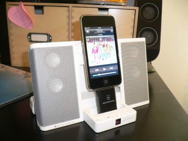

...unless I use my new Scosche Passport where it charges fine, although the Touch sits way up high.
