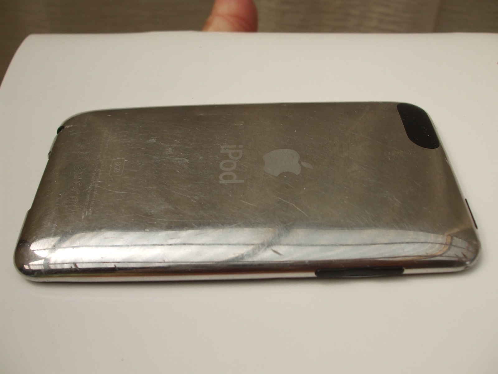

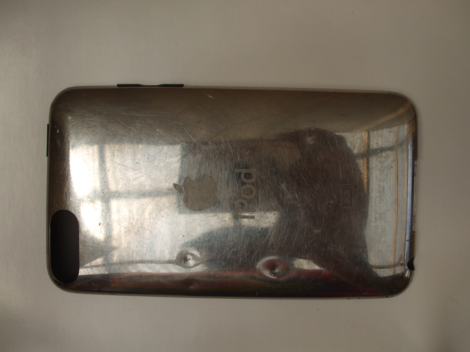

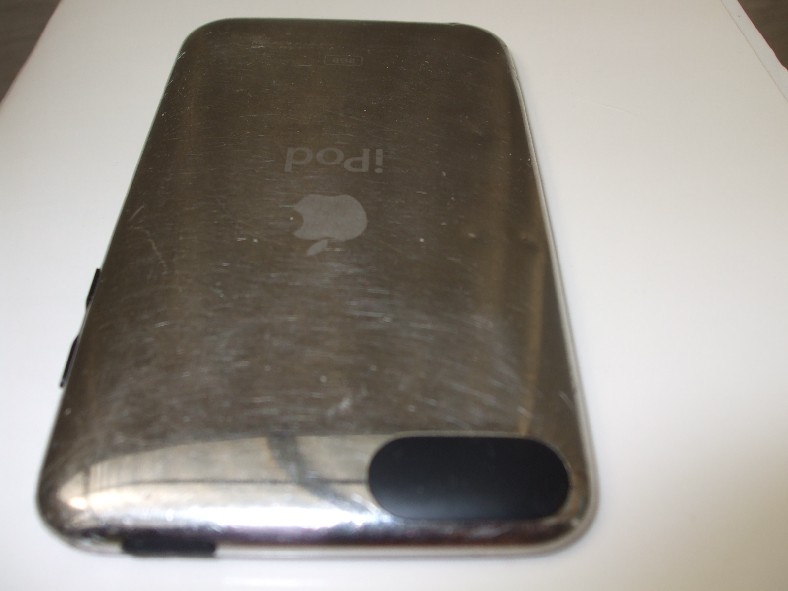

Hi there,
I am an iPod touch newbie with no spec knowledge etc... and now I want to replace cracked display glass. So far I still can use it but very bad screen visibility...
I googled and went to eBay stores to look for a replacement glass but there are so many replacement glasses out there...
1. So I need to determine which generation (1, 2 or 3rd gen.)of iPod?
2. I am wondering that do I have to replace a digitizer as well?
I do appreciate your help.
Please look at attached photos.
thanks

It seems to me that it is the 2nd generation iPod Touch. That aluminum backing looks pretty banged up, what happened?
That looks like a 2G/3G. If it still connects to itunes, find out the serial number and you can make sure. I'm pretty sure they use the same LCD's anyway. The digitizer only needed replacing if you've also lost touch responsiveness.
