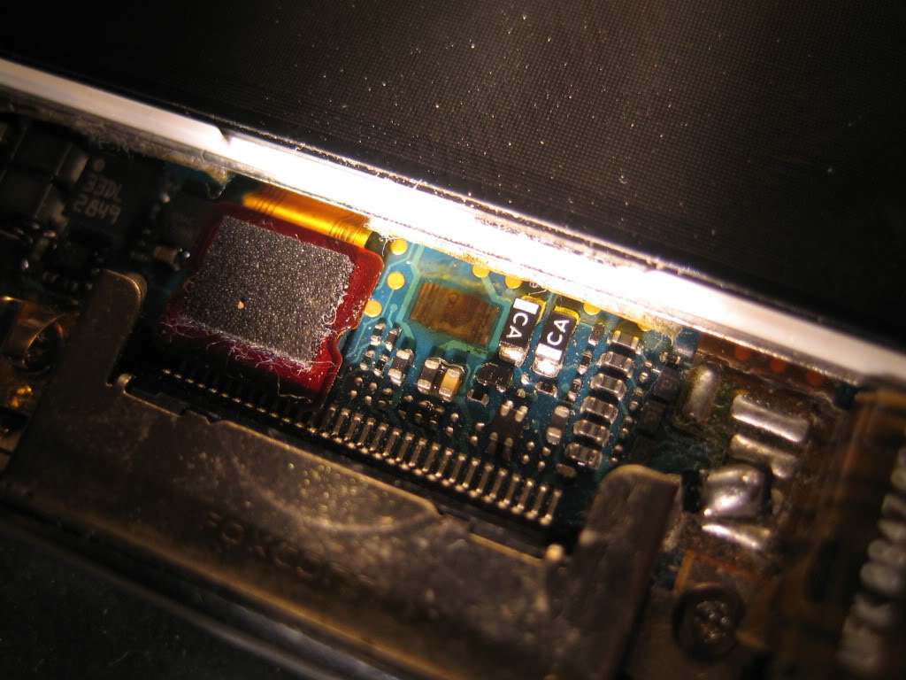

I was given an iPod Touch 2nd Generation to fix and in the process I broke off the little "Z" shaped spring that makes the home button work, that wouldn't be a problem but I also broke off the solder pad underneath it. (hence my user name) I can't find any trace around it to solder to but I know there has to be one...does anyone know where it is or what an alternate solder point is? I already know about the Activator/SBSettings method of simulating a home button but I'd rather not go that route...
I scraped around the edges of the solder pad a little but I can't find anything. Also, I can't find anything on the actual solder pad to show that it was connected. The Any input is greatly appreciated!

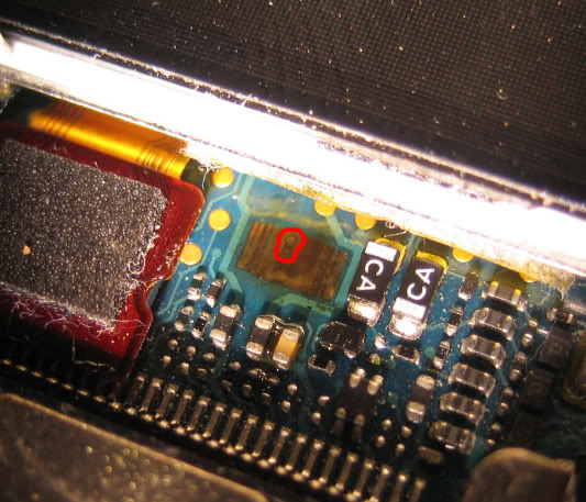

I was able to get it working, the little circle (highlighted) is the contact and I had to scrape it a little bit to expose enough metal to solder onto. The iPod works again!
