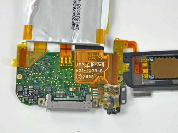

That depends on how good your soldering skills are.. or take it somewhere and see if they can do it.

If I were to try and rob a port from another ipod, am I correct in assuming it would not have to match the specifications of my ipod? (meaning an 8, 16, or 32 gb model), but it would need to be of the same generation?
Soldering micro SMT takes some skills and expensive equipment. Like a low powered microscope. Had that stuff when I was in the service and it really isn't a DIY job.
I agree, if you don't have the equipment for it or the skills, don't try it.

All that being said, if I manage to locate a 30 pin connector from any 3rd generation ipod touch, would it theoretically work on mine?
Tbf that looks alot easier to solder than i had expected, you will however need some tools to take the one off however it would be easy to solder on a new one with a small solder tip and microscope.
