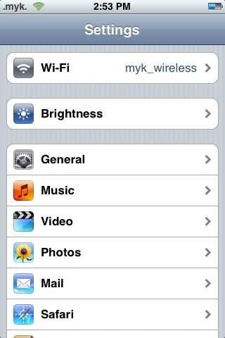

Here are some screen shots.

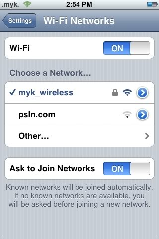

Do u see this image:
See if it works when you are standing right next to the router. Sometimes if there is a faint signal the network will show but you can't connect to the internet.
Probably not the problem but worth a check.

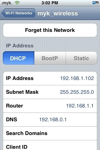

Click the arrow right next to your network.
It should look like this:

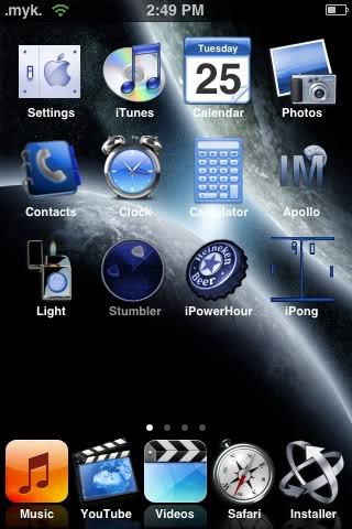

well first off.. how did u get ur home page to look like that?
its soo sick
but i went to my WiFi settings where u can see the DCHP codes and everything.. but most of it was filled in already. just with different numbers..
i can see my IP address, subnet mask, DNS.. but thats all.. everything else is blank.. the HTTP is turned off.. idk if its supposed to be.. but i turned it onto auto and it says to type in a URL.. so i just typed in my IP address.. and when i open Safari it says " Operation could not be completed. (POSIX error 12 - Cannot allocate memory)"

I finally figured out how to eliminate my problem. My DNS entry had 2 different IP addresses separted by a comma. I wrote down the 2nd entry; deleted the 192.168.0.1 entry; and then re-entered the 2nd address only. When I tried safari/youtube after that, I was then able to connect to server.
