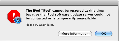

OK I've done that and I get the black screen and everything and I manually click on a restore file or I click to update and I get this:
The update server is down.
