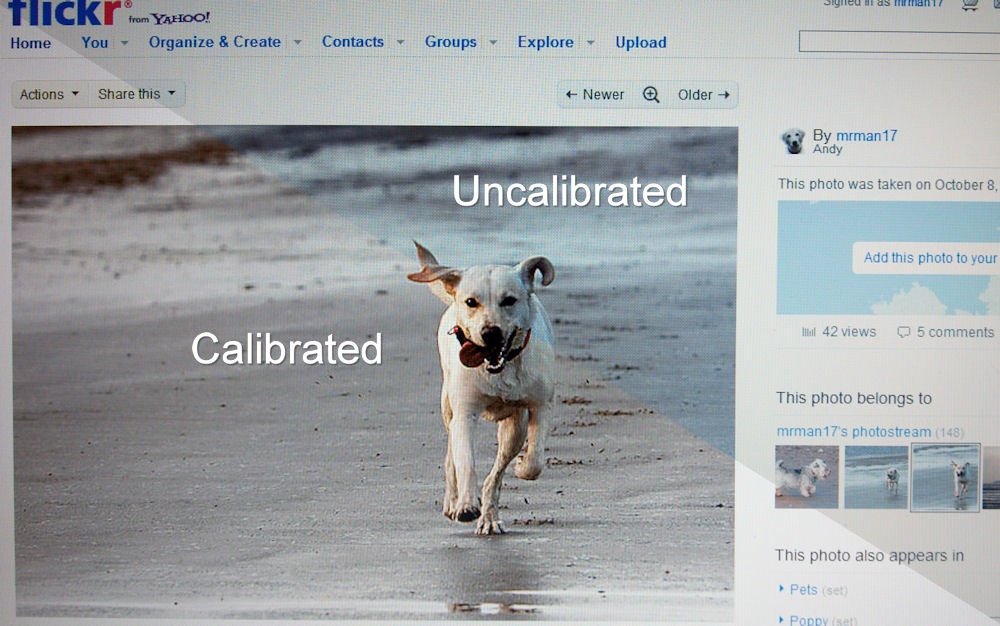

Here's an example that is an understatement of what you can expect between a calibrated and uncalibrated monitor (the example is a scenario where you'd start with an already decent monitor).
Also, don't listen to those people that tell you that you can calibrate your monitor with a USB device you buy for a few hundred bucks either. I've bought plenty of these from 5 seperate manufacturers and tested each one on at least 2 displays. These things can get within a vague ballpark of what is "calibrated" but more often than not they are way off the mark. I have never seen one do a job that isn't visibly way off the mark, under $3,500. Yes you need a $3,500 tool to calibrate a monitor properly. In fact the image above is about the difference between what I see with a Sony refference OLED monitor verified for calibration with a minolta display color analyzer. ($20,000 package), and what an xrite i1display gave me as the "proper calibration" (which it changed it's mind on repeatedly fyi),

Okay the important things are factory calibrated doesn't mean that much, as you don't know the targets used or how many points are measured. Typically it's just the center to whatever target. It doesn't help with uniformity unless further correction is implemented specifically for that. Backlight bleed and viewing angles are their own issues. You should look at reviews rather than just trust the manufacturer that it's calibrated to their standards.
Calibration in the software sense just means you're rewriting a profile. It measures the basic behavior. It makes some pivotal adjustments at specific points per channel. Trying to hit a specific target is a secondary adjustment, as shown in that calibrated vs uncalibrated. It's obviously not the native white point that was used as a target.
Even after "calibration" with a colorimeter, even if you do everything right including allowing the equipment to warm up and letting it run with minimal ambient light, it's not a guaranteed match to any non sRGB target. I mention sRGB as it's the typical ubiquitous close enough reference for computers, phones, and tablets.
