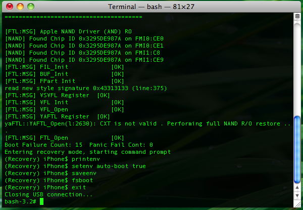

Almost all tutorials online telling you how to get your phone out of recovery mode by using iRecovery say to use the command printenv to check the value of auto-boot boolean. The problem is, whenever I use the command, nothing happens, it just returns to the prompt. It's the same as for the other commands I type e.g.
setenv auto-boot true
saveenv
fsboot
None of them gives any visual response, they all just return to the prompt so I'm not sure if they are doing anything. Can anyone see if I am doing something wrong? Am I miss a switch or something?
The only command that seems to do anything is "reboot" which isn't much help as it does just that, reboots into the previous, stuck on apple logo state.

The first time I start iRecovery, it shows this:
[FTL:MSG] Apple NAND Driver (AND) RO
[NAND] Found Chip ID 0x3295DE987A on FMI0:CE0
[NAND] Found Chip ID 0x3295DE987A on FMI0:CE1
[NAND] Found Chip ID 0x3295DE987A on FMI1:C8
[NAND] Found Chip ID 0x3295DE987A on FMI1:CE9
[FTL:MSG] FIL_Init [OK]
[FTL:MSG] BUF_Init [OK]
[FTL:MSG] FPart Init [OK]
read new style signature 0x43313133 (line:375)
[FTL:MSG] VSVFL Register [OK]
[FTL:MSG] VFL Init [OK]
[FTL:MSG] VFL_Open [OK]
[FTL:MSG] YAFTL Register [OK]
yaFTL::YAFTL_Open(l:2630): CXT is not valid . Performing full NAND R/O restore ...
[FTL:MSG] FTL_Open [OK]
Boot Failure Count: 15 Panic Fail Cont: 0
Entering recovery mode, starting command prompt
The Boot Failure Count seems pretty constant each time I look.
iRecovery does not show any response to my commands but seems to take at least the reboot command. Perhaps someone thought it would be nice to disable the output.
