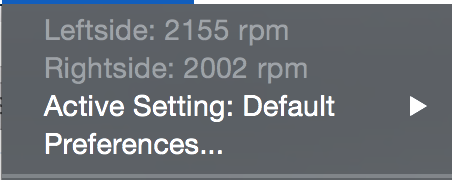

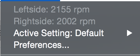

Yes, the fans are ALWAYS spinning, unless the unit is asleep or off. The minimum fan speed is different between 13 and 15 inch versions(13 being lower). Here are my fan readings at idle for my 15" rMBP

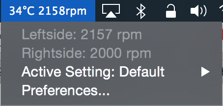

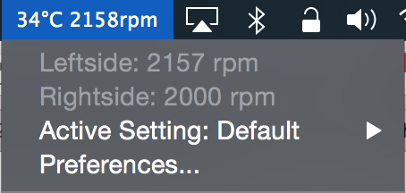

Idle Temps- 33-37C Fan RPMs are 2160RPM Left, 2000RPM Right. Fan Speed doesn't change by more then 100RPM until 57C in which case it will go to about 3200RPM Left, 3000RPM Right.
Here is a current screenshot...

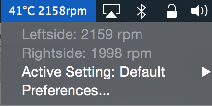

104F = 40 C. Thats nice and cool, is that pretty typical of your MBP?
This is what iStat Pro shows. Even when the fans speed up to over 5,000 when doing processor intensive things, it doesn't seem to get too much hotter than that.
