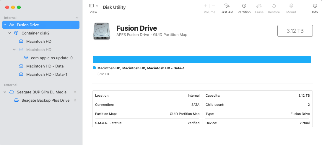

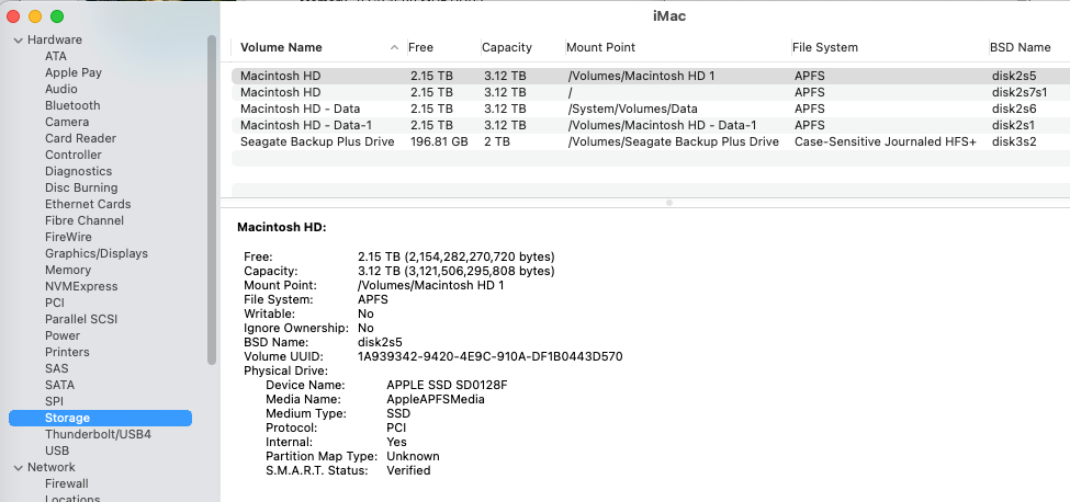

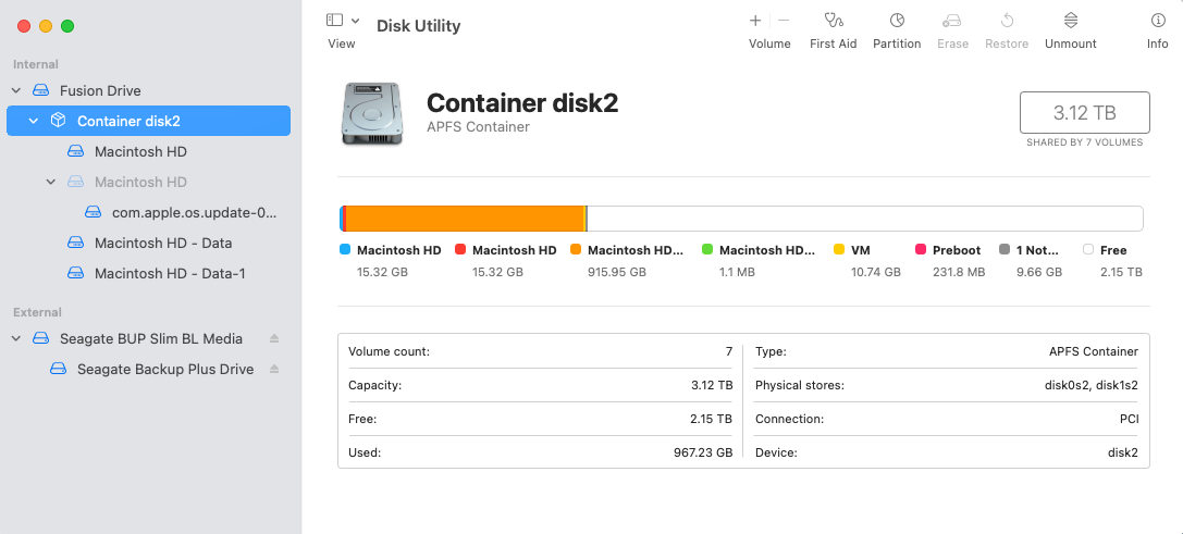

Thanks for the advise! I've got a 3.12 TB internal APFS Fusion Drive that has 2.16 TB (6.79 GB purgeable?) available. However, it has a configuration that I'm not sure how it happened or what to do about it (see graphics).
Somehow it is "shared by 7 volumes" which somehow occurred when I upgraded to Big Sur twice (reverted to Catalina troubleshooting a problem, then did it again). The two "Macintosh HD"s appear on my desktop along with "Macintosh HD - Data-1", and because they've not caused a problem, I've just let them alone . . . . until now. One of the Macintosh HDs apparently contains all of my files under my user name, while the other one contains only duplicate general folders/files, but no "users". The Macintosh HD - Data-1 doesn't appear to contain anything (all of my files in Macintosh HD - Data. Although the "Container disc2" appears to contain all of the others, I'm not sure where it and the "com.apple.os.update-0..." reside. Also, the applications folder in the "Macintosh HD" with all of my files contains the "Patched Sur" file/folder (uninstall??). Can you help with this mess?
Lastly, by partitioning the HD, I assume the intent is to be able to run either Big Sur or a later OS (Ventura). I don't think I really need to do that, as I don't know of any applications that I would lose going to a later OS (???). Again, thanks for your help!

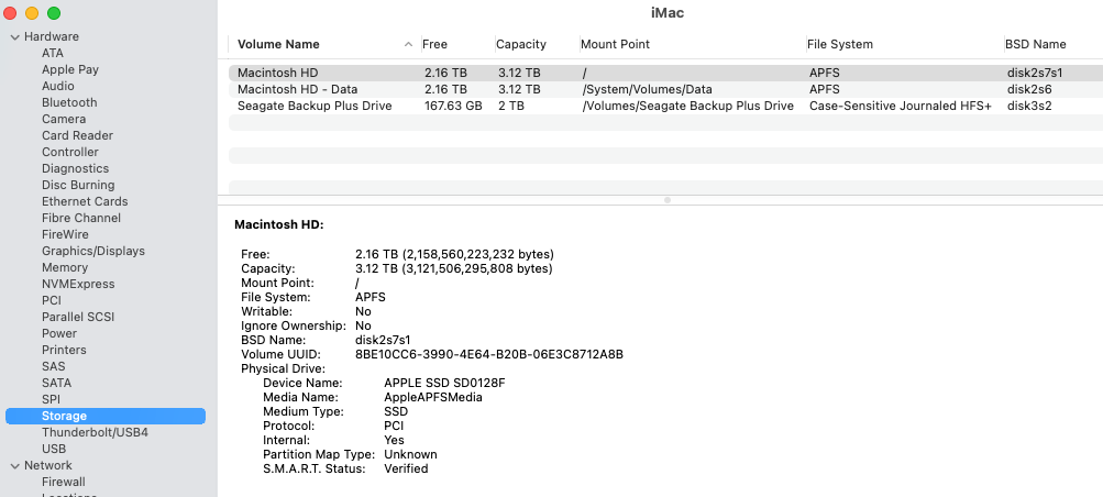

OK, using "Disc Utility" I selected "Delete APFS Volume" for my extra "Macintosh HD" and "Macintosh HD - Data-1" volumes with nothing affected on my machine. The Fusion Drive now shows "shared by 5 volumes", all of which have a function. From here do I proceed with the upgrade to Ventura OS using "OpenCore Legacy Patcher", or do I need to partition my HD first and/or delete the "Patched Sur" files?
Someone else ought to chime in here, just to check my work…

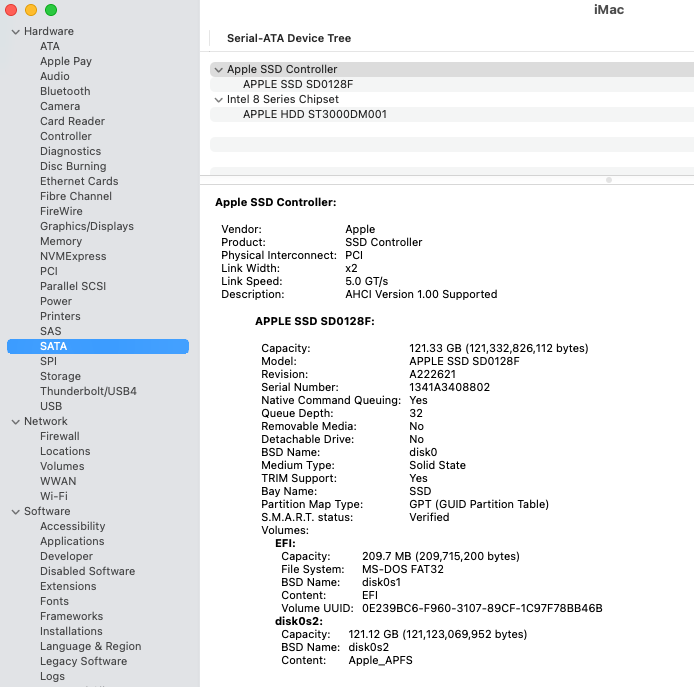

I think I do have a solid state HD (APPLE SSD SD0128F, see below graphic), or is that the "blade" you mentioned? If my "Fusion" drive is a SSD, am I then configured (see 2nd graphic) to proceed with the OCLP upgrade to Ventura (Sonoma??)
You have a “blade” AHCI PCIe SSD and a spinning SATA HDD configured as a Fusion Drive. This is not a “pure” SSD setup.
Yes. Correct.

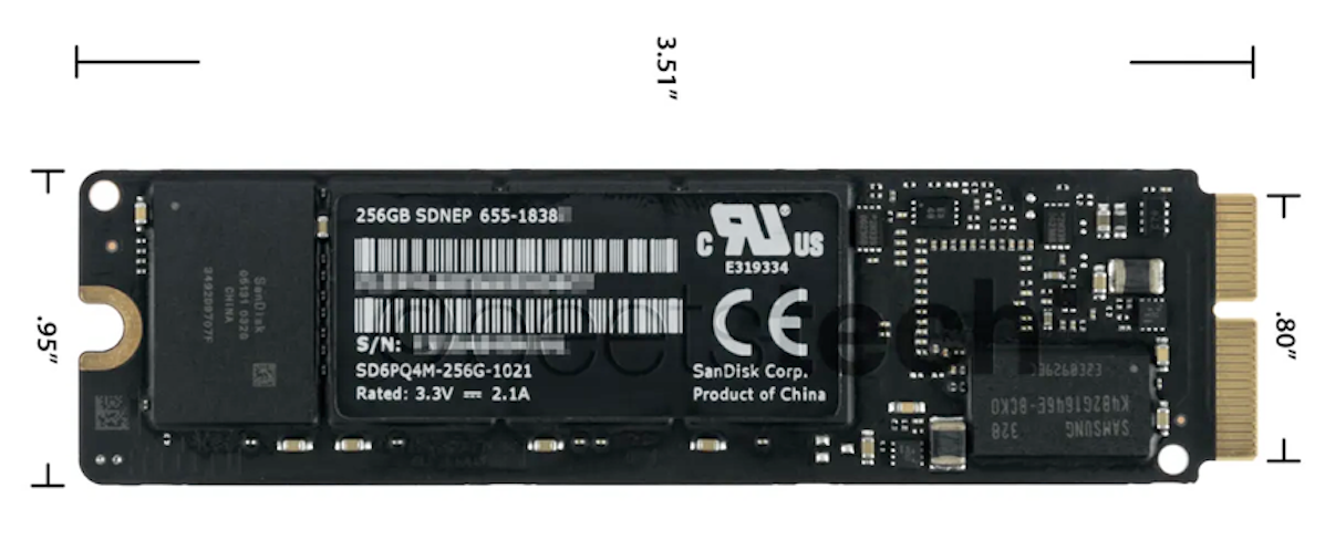

The late 2013 iMacs shipped with a receptacle for the Apple version of the NVMe/PCIe SSD blade (in 2014, to save costs, Apple didn’t populate the receptacle on the main board for units which were not ordered with Fusion drives, despite the contacts on the board still being present). Fusion-equipped models actually use the receptacle; models like mine, which shipped only with the HDD, have the receptacle, but is empty.
That’s the “blade” in question. The form factor of an NVMe SSD — whether the standard m.2 or the proprietary Apple-style — looks like a thin “blade”. In this case, the “blade” is 80mm (8cm) in length — or, size “2280” (they also come in “2242”, “2260”, and even a very long “22110”, with 2280 being most common).
Here’s a standard m.2 NVMe SSD form factor:
Here’s an Apple version with proprietary connectors:
Here’s an inexpensive adapter which enables one to use a standard m.2 blade with the Apple-proprietary receptacle found on the rMBPs, MBAs, and iMacs of ca. 2013:
If my "Fusion" drive is a SSD, am I then configured (see 2nd graphic) to proceed with the OCLP upgrade to Ventura (Sonoma??) without doing the drive partitioning you mentioned earlier? Delete the "Patched Sur" from my applications folder?
So yes, it looks like your iMac shipped with the 128GB SSD blade (more accurately, 121GB, with 7GB “over-provisioning”, which is a common feature for SSDs of all kinds) alongside a 3TB HDD. Your system reports “3.12 TB” because it has the 3TB HDD + 120GB SSD combined in “Fusion” configuration. To your system, outside of Disk Utility, your “Macintosh HD” is one logical drive.
