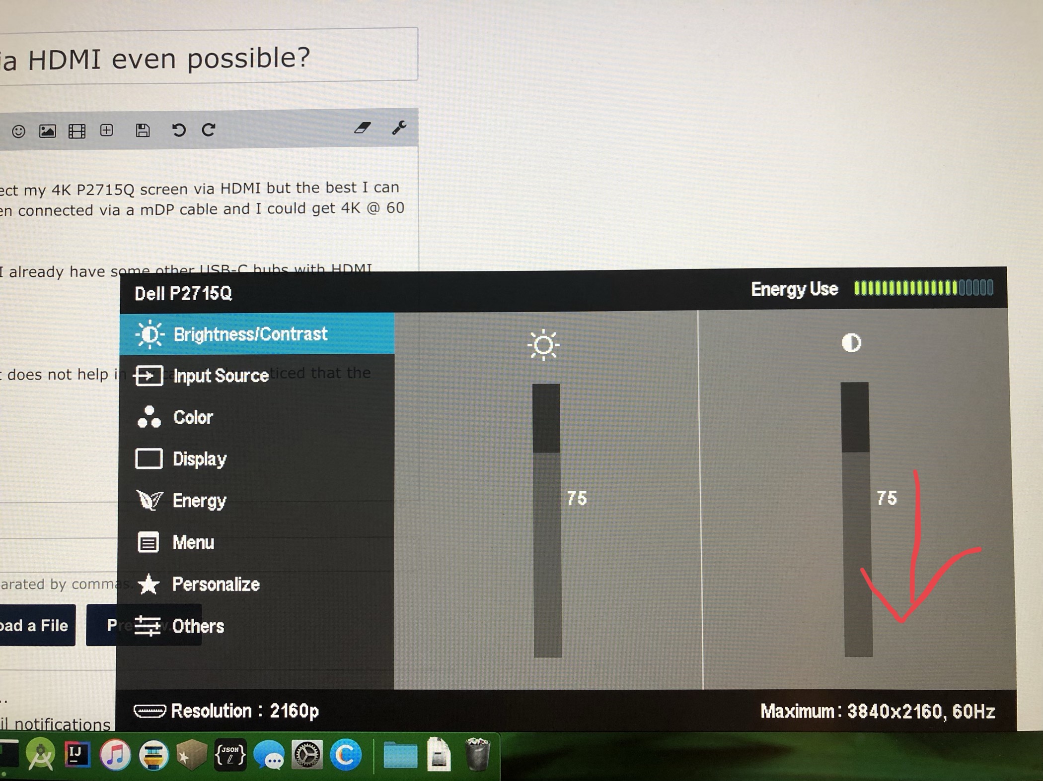

I have a 2017 macbook pro 13" and I'm trying to connect my 4K P2715Q screen via HDMI but the best I can get is 4K @ 30Hz. On my previous mac, I had the screen connected via a mDP cable and I could get 4K @ 60 Hz.
When I use a USB-C to mDP adapter, it works fine but I already have some other USB-C hubs with HDMI ports and I'd like to avoid getting yet another adapter.
Is 4k at 60Hz event possible?
I found some DELL support pages about this topic but it does not help in my case. I also noticed that the screen itself reports 4K@60Hz
while macOS only 30Hz
