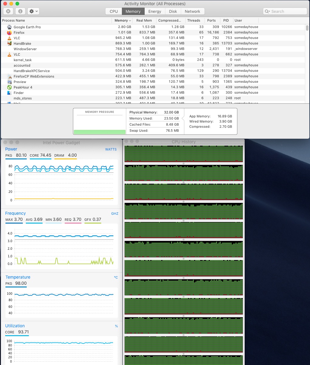

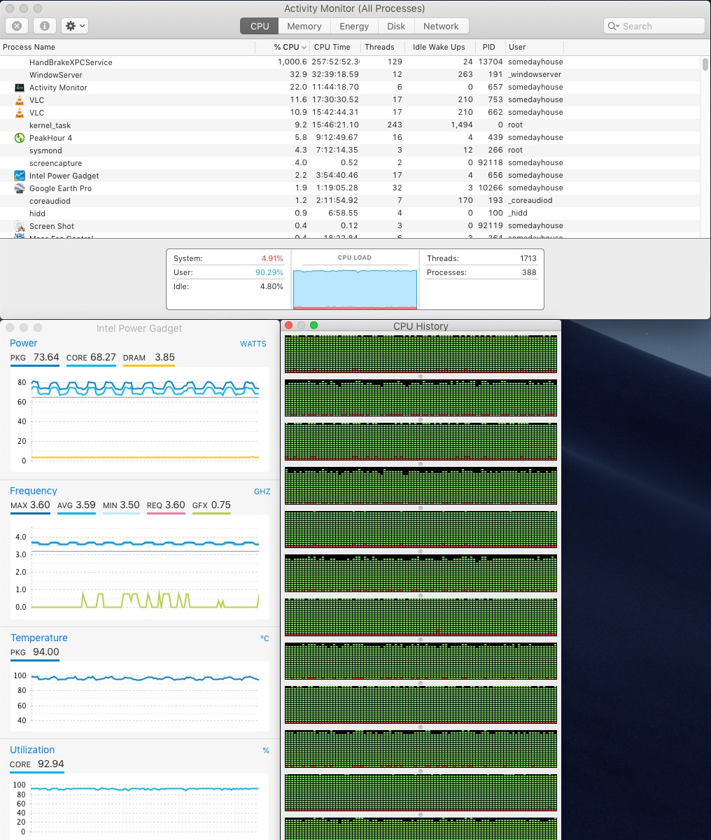

I know this isn’t the OP’s use case. But for others following this thread….
I’ve been transcoding a lot of real time video stream files (.ts) into mpeg 4. This is what that looks like on a 2018 i7 Mini with 32 GB RAM.
This mini is my main computer. For everything else i do, the i5 would have have been plenty. But this transcoding uses 95% plus of the i7 with the temps at 90+C and fan running 4700+rpm.

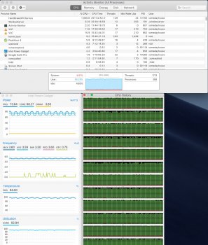

View attachment 935047 View attachment 935048
GetRealBro
It will use almost all your CPU power because it is moving a large amount of data, because a movie is basically a series of moving still frames, from memory to storage through the T2 chip or Intel Quicksync accelerator, unless you are doing solely CPU rendering which may even get hotter, not T2/Quicksync rendering.
This is the reason why Apple is moving to the Apple Silicon Chip where all of this will be moved into one single chip where it is done internally. Less heat and more efficiency which translates into faster encoding with no fan noise. Which is why Apple Silicon Macs can be very appealing as a nice fast efficient compressor box. Quite, cool and fast, because the T2 is an Apple silicon chip.
