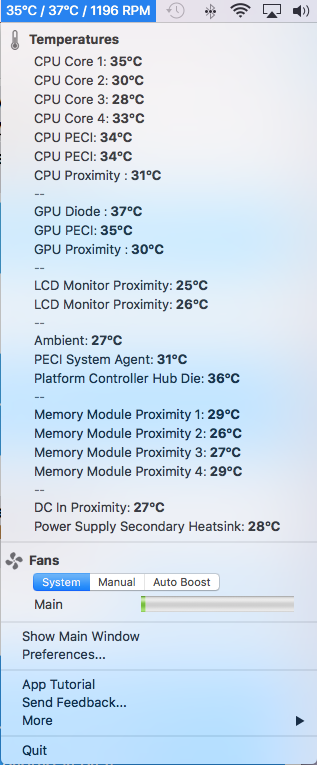

I use TG Pro for seeing system temps and setting fan speeds (although I just let the stock profile handle it). Its not free software however its a very good piece of software and well worth the 10 bucks or whatever it is. When it comes to temps and fan settings its probably the most comprehensive piece of software available, at least in my opinion. Its also well supported, still sees updates and I even think one of the devs or owners/employees post on this forum from time to time and takes user feedback very seriously.
This is just the drop down from the menu. The actually preferences offer MUCH more...
And no I have no other affiliations with them.
There is other free software available. However with this (or other software) you can test your fan to make sure it works and know the sensor readings are accurate.
