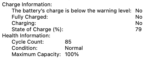

Lots of daily charging to 100%. M3 MacBook Pro base model used heavily. Lots of discharging until it nearly switches off by itself, around 3%?
