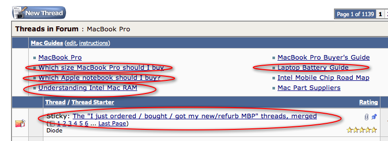

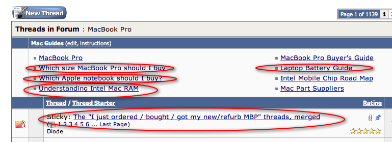

People don't read sticky posts or guides, either, or we wouldn't have so many threads on the same topics:
