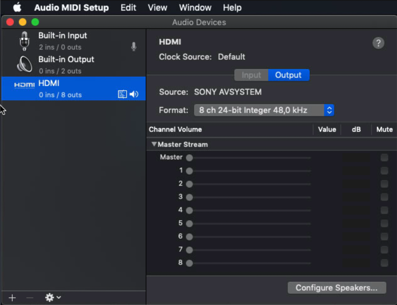

To get 5.1 sound, you need to open Audio MIDI Setup.app and configure multichannel output.
You will never see a Mac listed by name under devices, because Macs lack the HDMI-CEC function.

Thanks Priitv8. What I meant was that when I have my late 2012 Mac Mini plugged directly into the STRDN-1080 using a premium HDMI of which I’ve tried a few, the latter does not show in the former by name. You’ve kindly just explained this though! The other problem I’m having is that when I have the Mac Mini plugged directly into the STRDN-1080 using a premium HDMI, then only some, but not all video files play in 5:1. I’ll post a screenshot of the audio midi screen as this has strangely changed from 8ch out to 2ch.
