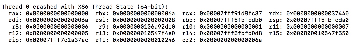

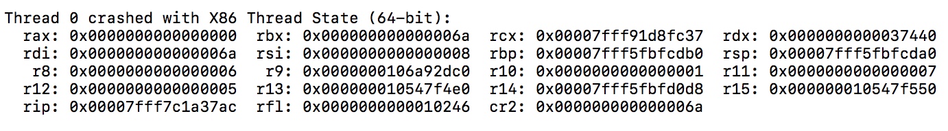

Ok, bit of background is needed here. Let me attach a screenshot of a crash to assist in my explanation.
If you look at that register dump from one of the crashes that I've found (this one was in Safari) it shows the values of your computer's registers had at the moment of the crash. This information is recorded in your system files, and is viewable via the Console application in Applications/Utilities/. A simple check for exploitability is to see if any of those register values appear in the source file data, or input data as the case may be. If it does, and it manipulates the correct registers (ideally the instruction pointer) you can take control over the crashing application and execute your own code. It's that simple. By not updating your applications / software you are not receiving protection against the most recently found vulnerabilities.

Exploit code usually just changes register states of an application during crash to execute instructions at a machine level.
That's how I understood things:
RISC and x86 are completely different at the instruction layer. Even big and little endian PPCs are different. I just cannot believe that there is an 'universal' exploit. Register reading exploits target one specific processor layout. Also the latency is important - older architectures are much slower at certain things and because of processor evolution less bloated. Some things simply can't work, others take up too much time or use a non existing command (eg call a vector like sse) - the chain breaks and the exploit or whatever malicious code is used becomes useless.
Now please correct me if I'm wrong, I'm always open for more knowledge 😉
Did you even read the linked exploit? It specifically includes PPC instructions, but honestly, who would do that today?
As I thought you're referring to a very low level aspect of the system which is not going to be the same between various processor architectures. Thus register manipulation, at least the actual implementation and not high level theory, in one architecture is extremely unlikely to work on another architecture. The registers available and how they're utilized are different between different architectures. Thus you are supporting what has already been said: At this level shell code is going to be very architecture and operating system dependent and thus what works on one is very unlikely to work on a different one.

The shell code might work when using a cross platform technology such as JavaScript. It is very unlikely to work against Safari itself unless it was specifically written to target Safari.
That last bit right there is the key. Most exploits that we're worried about when considering this PPC thread's subject are surrounding Safari, or whatever browser they choose to use. Since they can't update those applications (stock mac apps anyway) then thats where you're vulnerable. Have I made the point clear yet?
Edit: The 'exploit' being specifically written to target Safari is something you can assume. Vulnerabilities are rarely tied to hardware, but they do happen as evidenced by Intel's laundry list of security advisories. Part of my day job is going through vulnerabilities that come out every day and writing audits for them. I'd estimate that 95-98% of the vulnerabilities that I end up going through are software specific related.
