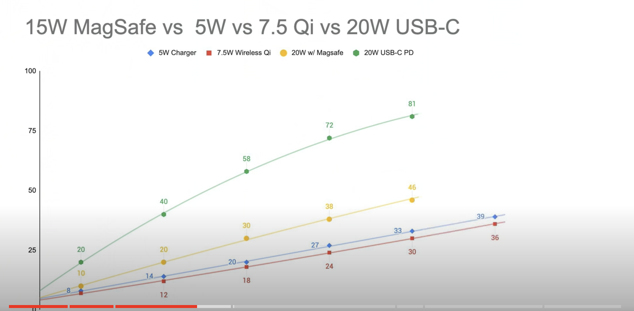

Maxtech has a video about the differences between various charging methods. More watts does not necessarily mean a faster charge. Screen shot from 3:37:
Reactions: Slartibart
Helpful video. His tests remind:
• Wireless is much less efficient
— Need I say more? Okay. If every bit of speed is very important, wired is best.
• “Fast charge” is only up to 50% of the battery capacity
— The charging rate significantly ramps down at 50% then at 80% to preserve battery health
• Not all power adapters are the same
— How much and quickly/often they negotiate the rate with the device varies by device and adapter
• Performance varies by device model
— Each iPhone model has a different battery with different capability (i.e., an iPhone 12 mini can’t charge as fast as a 12 Pro Max)
— This is also shown in tests in the article I linked to earlier.
