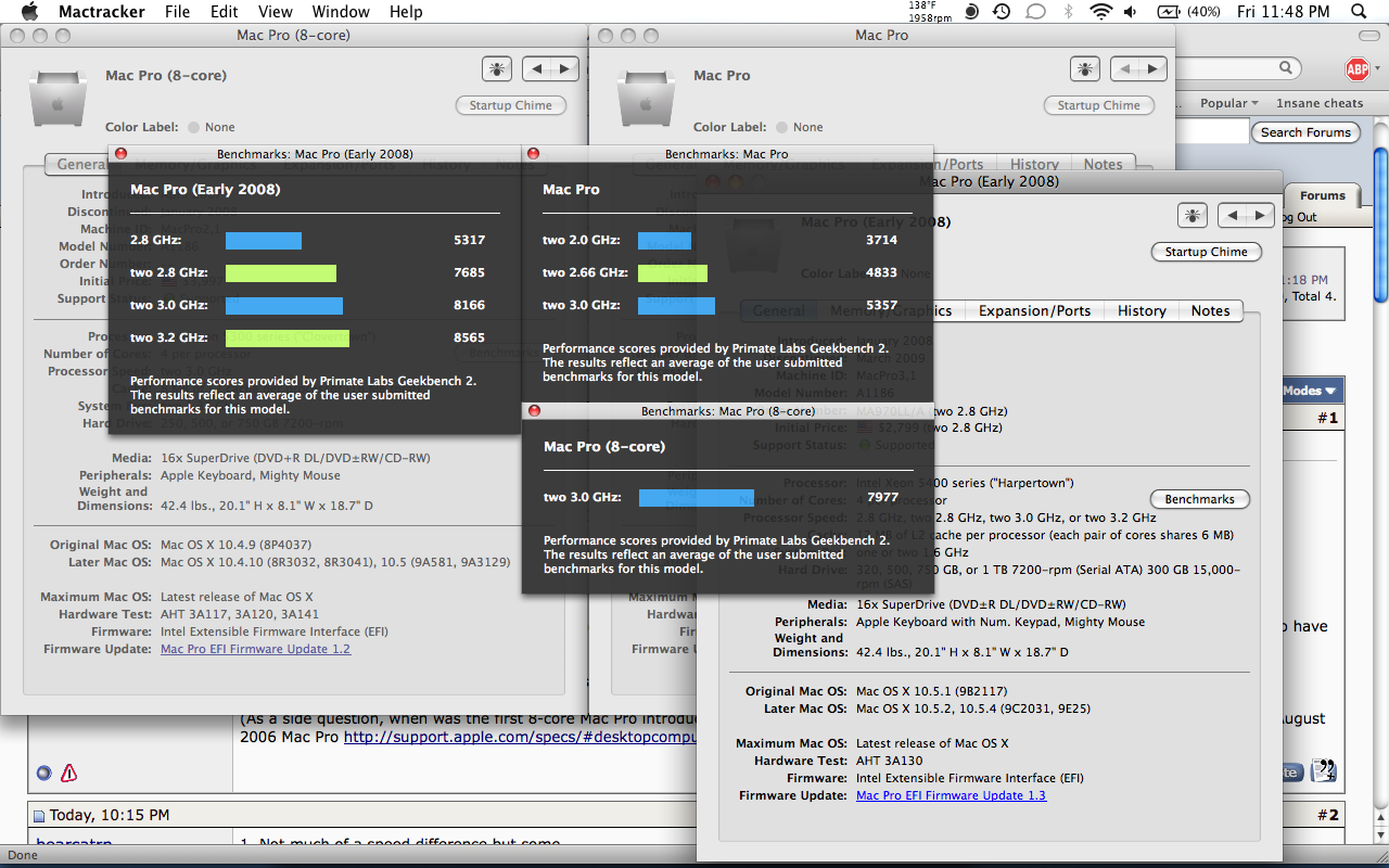

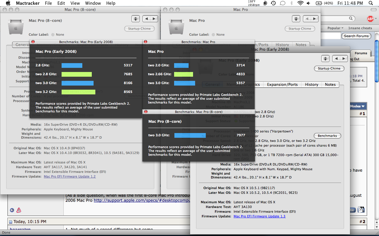

Mactracker is good at finding out the various specification for Apple models - if they used a comparison other then Geekbench, it would do fine.

😱 Geekbench? Eww.... 😉 😛
u meant " Macktracker? Yaa 😀 "
Yeah, MacTracker is a little different in that it takes all 1000 scores or however many there are, and averages them all together - and for each model. So it's MUCH more useful than GeekBench alone and almost useful. 😉
I wasn't aware of that.
A few crazy people with RAID, and lots of memory (resemble anyone? 😱 😉), could skew the results enough to frustrate some if their base models don't make the average. 😛
Or does it sort those scores out as outliers, and dis-include them in the results?
