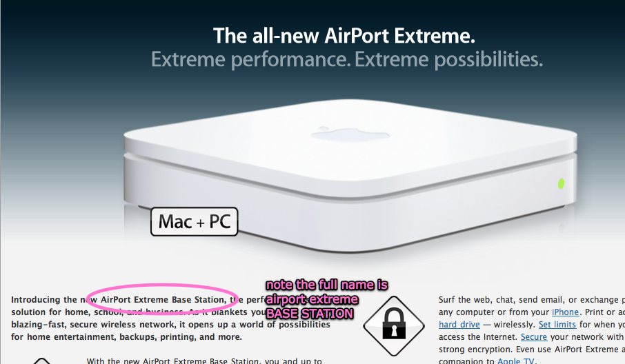

Or do you have to buy an Airport Extreme AND and router to be able to connect to the internet?
more precisely, the airport extreme base station is a router. "airport extreme" can be applicable to both the base station or just 802.11g/n in general. all macs ship with airport extreme installed, but that doesn't mean all macs ship with wireless routers.
