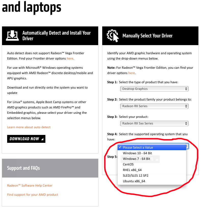

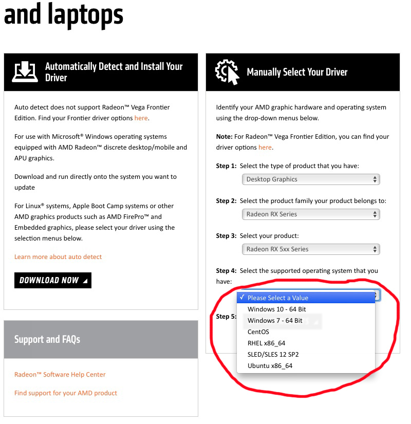

Are you aware that AMD will not be supporting Win 8 - only Win 7 & Win 10 drivers are listed on their driver download page.
Win 7 Ultimate is much easier to install than Win 8.1 or Win 10 as theyr need GPT formatted HDD's.
I couldn't believe that so checked it out....barking mad! There is an 8.1 version of the AMD driver package, it was unable to find the card. I have a second monitor on the way, so hopefully that'll help sort the problem. I'll probably upgrade the install to 10 now it's (mostly) working properly.

Beware that there could still be inherent issues with the Win 7 drivers. People told me that my GT 120 was at fault; however, if it were truly at fault, why would it cause my RX 580 to suddenly work? My 580 does NOT output anything until the GT 120 is in there with it and has its own generic drivers installed and enabled.

It was the 5.1.5621 driver set, everything except the Realtek drivers which kept causing issues- I use an iMic for sound anyway. The BC control panel works fine for booting back into OS X. What doesn't work is trying to set up Windows as default startup disc- if I do that it just hangs at the grey screen (with GT 120) without actually booting any OS at all. In order to get into Windows- version makes no difference- I have do it via the boot screen, and give the Mac a little time at that screen before selecting Windows, otherwise it hangs again. Not sure if this is down to the Mac being a flashed 4,1, or what…no issues starting into OS X on any drive, HD or SSD.
Is that an older driver set?
Odd that it's hanging... and, I don't think it would have anything to do with the fact that it's a flashed 4,1. My own machine is a flashed 4,1. The one time where I couldn't boot back into Windows was after the latest Bootcamp drivers, for some reason, failed to install (without my knowing). The drive showed up, but it wasn't bootable.
