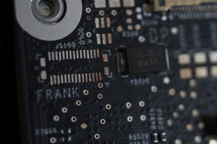

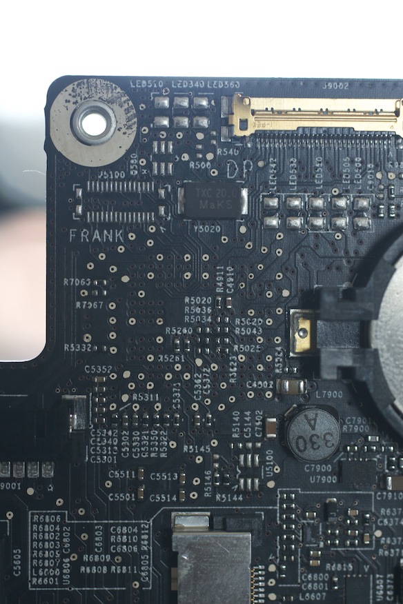

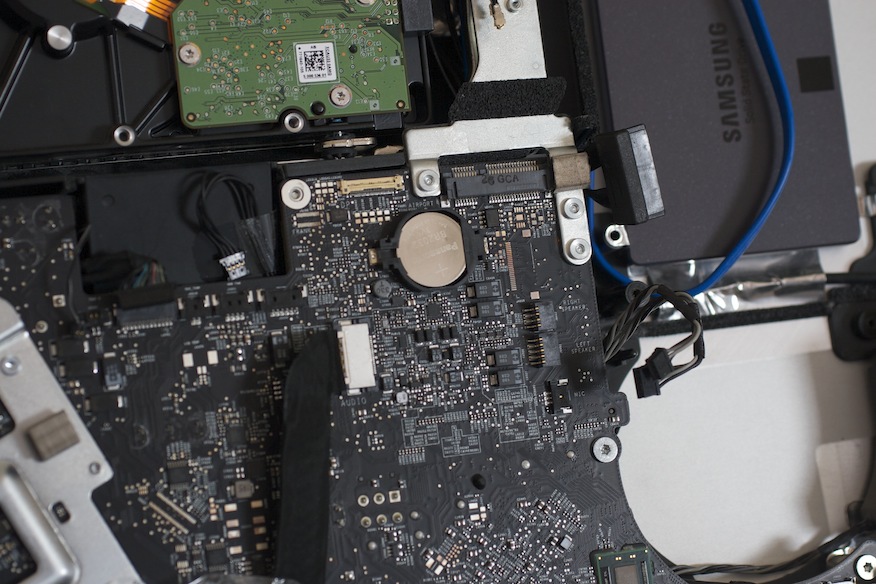

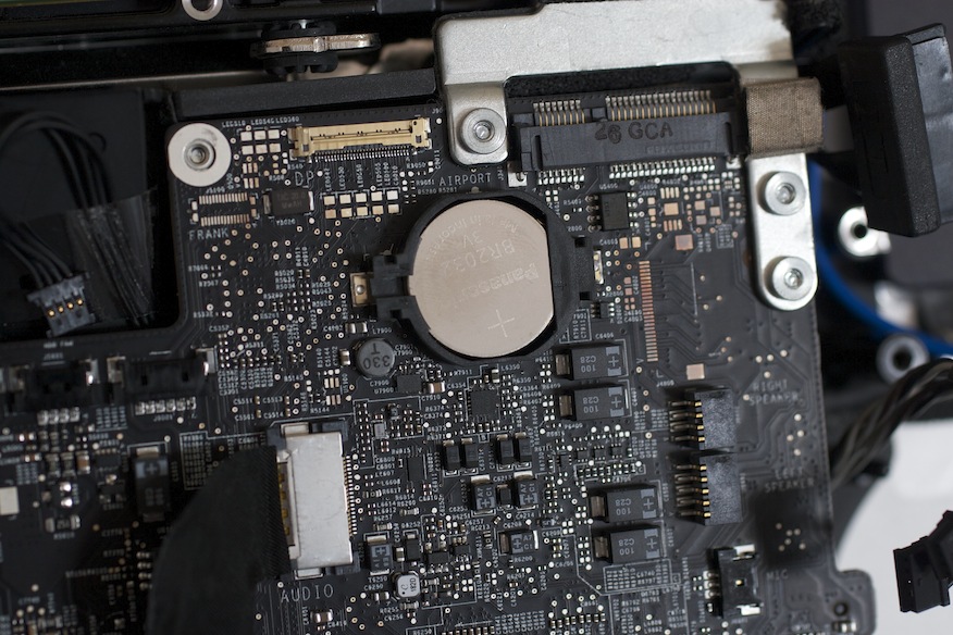

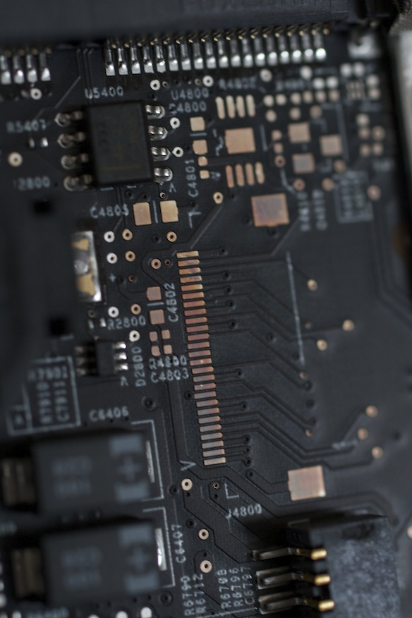

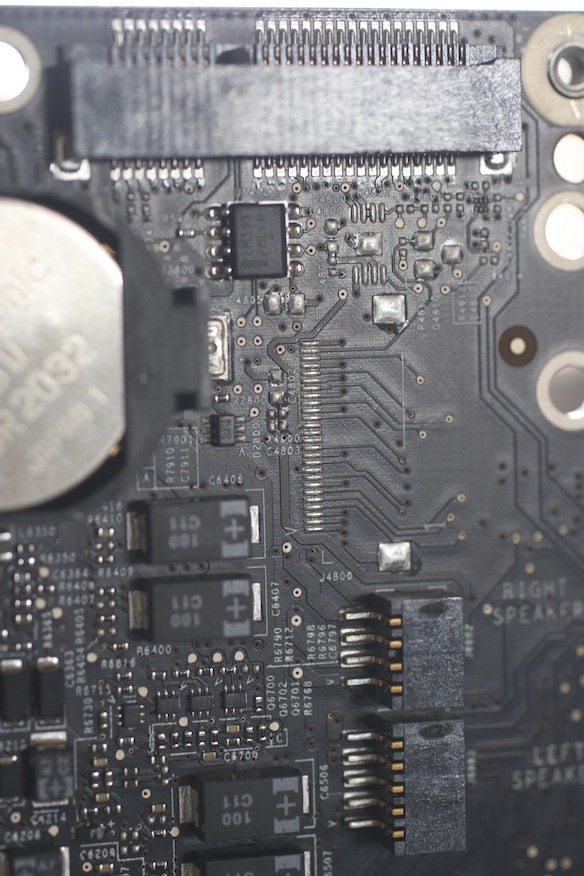

However, this time around, I can see some heat markings on the logic board itself. It wasn't like that, the last time.
I've attached some images, so you can compare for yourself:
These two shots, are images of the old logic board.
It did occur to me, however, that my installation of the SSD might have changed/obstructed the internal airflow. As you'd might now, the heatsink for the video card is in the top of the case.

I suspect the SSD install you mentioned could be the culprit. The iMac is a tough design for cooling. Any all-in-one enclosure is going to present problems with cooling so changing the internal airflow pattern in any way could be the cause.
