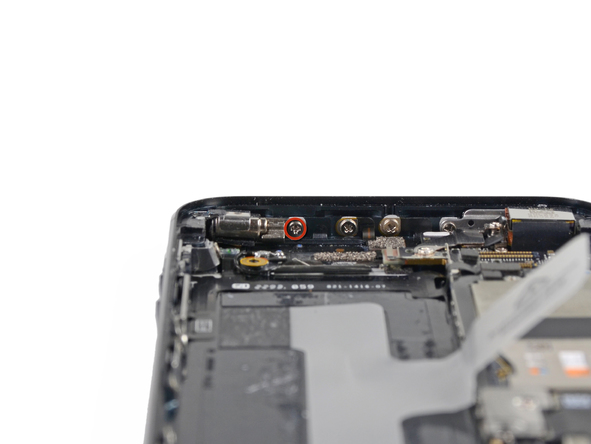

Its likely to be the vibration motor which has moving parts within. I took mine apart, shook the phone holding the cam down and could visibly hear the vibrator rattling together.
Its next to the circled screw.... the camera is on the opposite side.
Ive been into Genius twice for this now, once i was told it was camera, second time it was vibrator motor
I second this. If your meticulous enough and shake your phone next to your ear for hours you will hear the motor moving a bit which is normal. plus its near the camera. Same with the 4 and 4S.
Ive had conflicting information from Apple, so i decided to open up my IP5 (water damaged so didnt really matter in the end).
The rattling was actually coming from the VIBRATOR next to the camera port and not infact the camera lens as many think of being the cause. So i shook the phone whilst the case was off and could physically see the the vibrator moving in sync with the rattling noise.
Apple Genius confirmed this so i got a feeling it might be something to do with how tightly screwed in the vibrator actually is, i cant actually tell as the dozen or so ip5's ive checked out ALL rattle.
