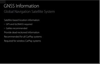

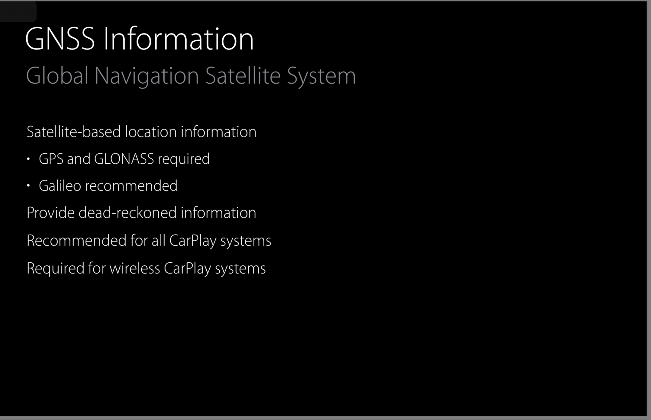

the first one in particular has this slide. GPS information is recommended as part of the standard for wired CarPlay systems but required for Wireless CarPlay because the phone is more likely to be out of sight (in a pocket or bag), have no GPS reception (again pocket/bag) and presumably the power drain figures in there too, though they don’t mention that.

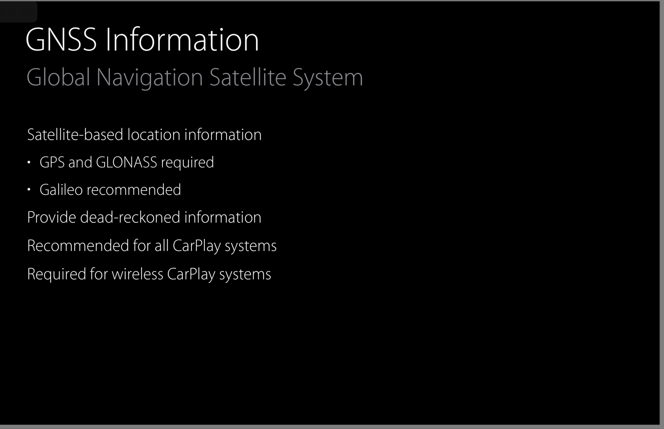

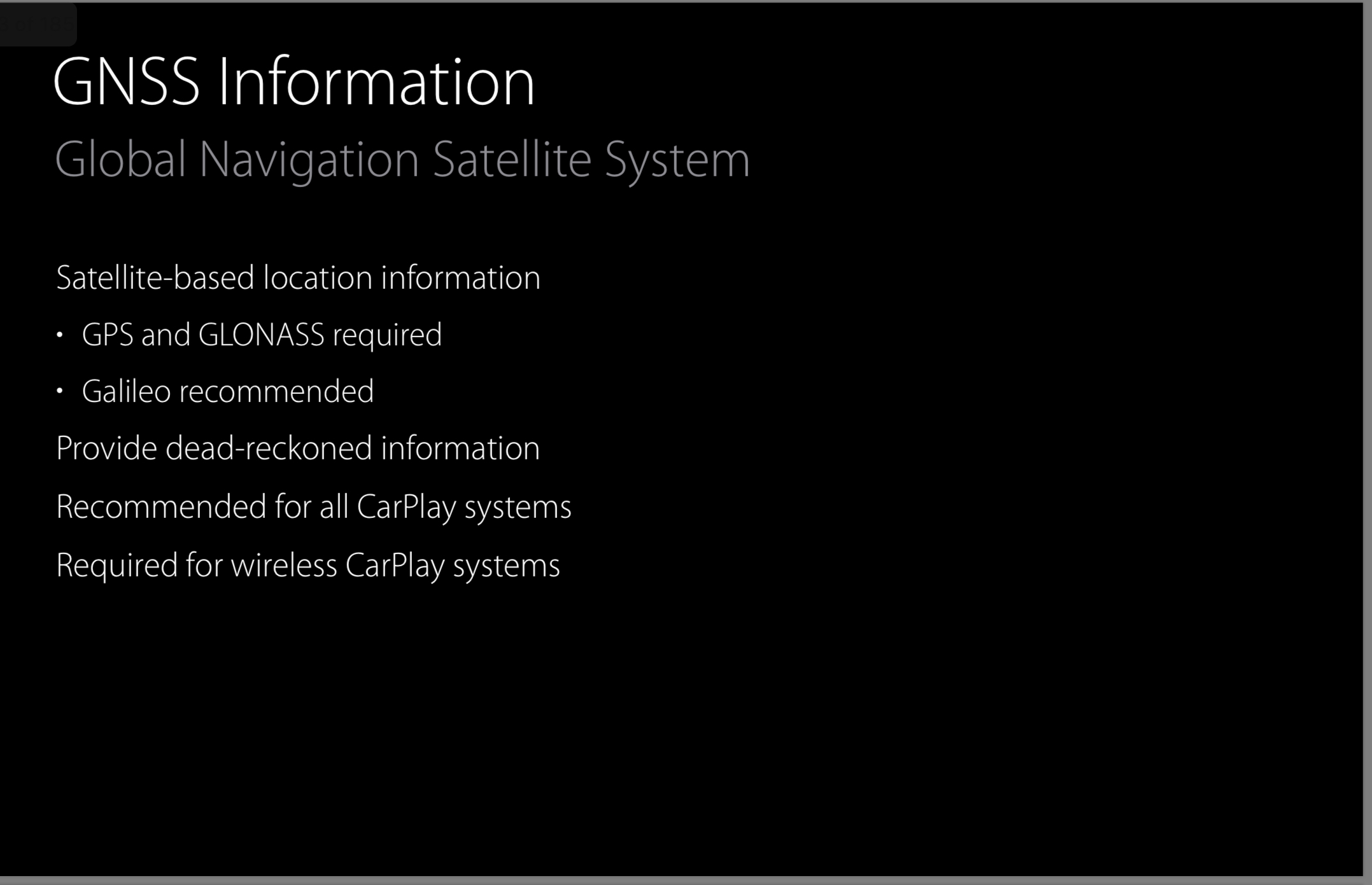

Looks like this is a big reason why very few car manufacturers support wireless CarPlay in their cars that support CarPlay.
