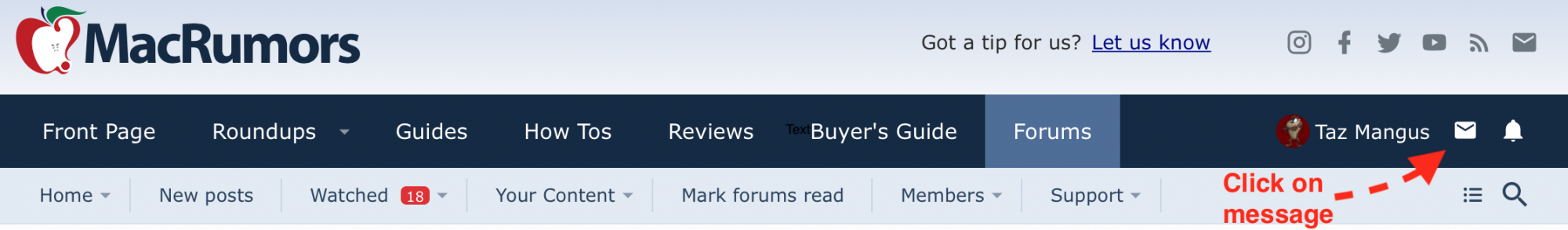

How do can I message Dosdude1 on here? I go to his homepage but cant figure out how to send a message.
Use the message communications from the macrumors website.
