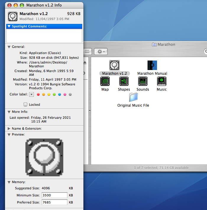

Marathon runs nicely in Classic on my PowerBook G4 under 10.4.11.
Try setting the Preferred memory size of the app a little higher. Here is the info window setup on my machine.

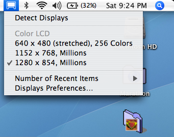

Also, you can setup the screen resolution and color depth to 640 x 480 @ 256 colors. Once you've done this once, click the "show displays in menu bar" option and you get a handy resolution switcher like this:
Reactions: Amethyst1
I didn't know you could do that. Thanks! Yes, this made Marathon playable. It did nothing for SC3000 however :p
