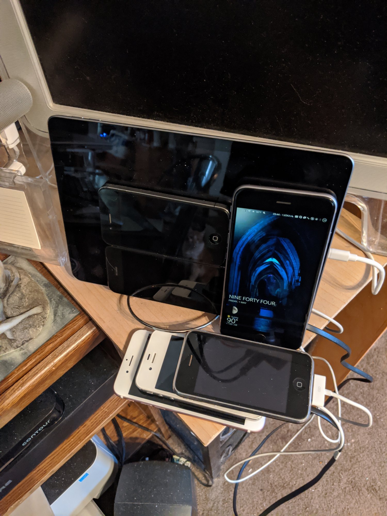

Only three of these devices were paid full price. The iPhone 5 was paid off in 2014, the iPhone 6s and 6s+ were paid off in 2017. The white 4s cost me $20, the black iPhone 4 cost me $20 and the 3GS which I just got last week was $29.
All of them are currently being used by me for various things. I don't let my devices sit in drawers. The iPhone 6s+ even has a current SIM in it with it's own active line.
