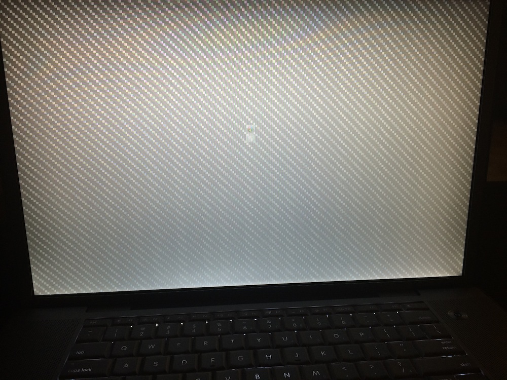

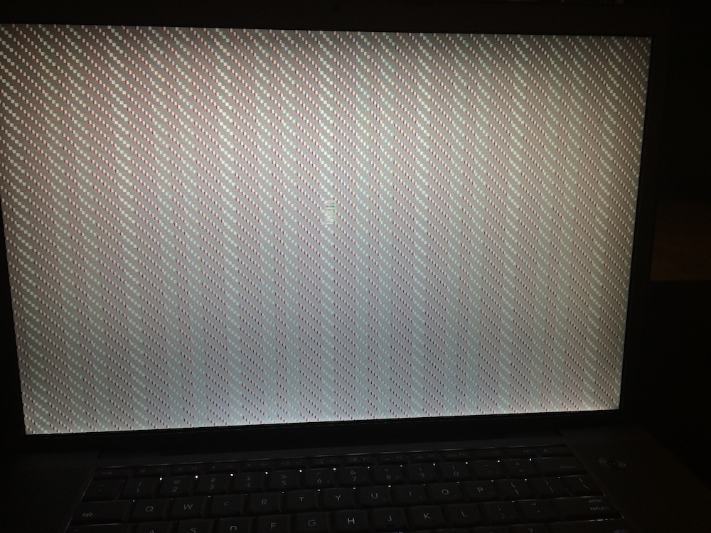

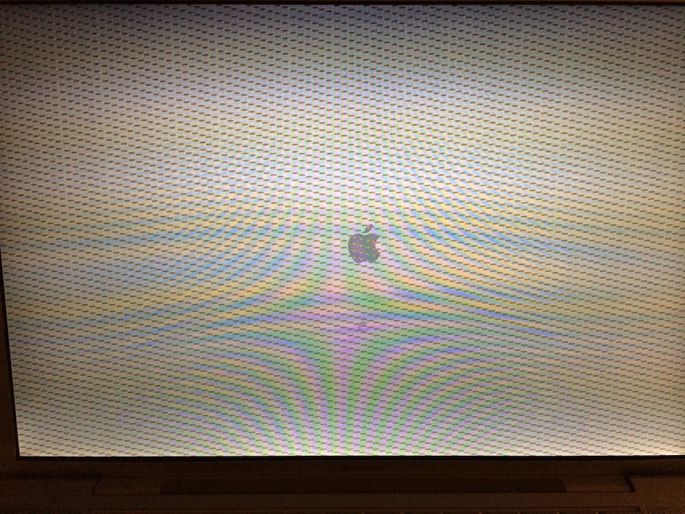

After 6 or so years, a new logic board, some memory upgrades, etc, my 17" macbook pro seems to have died, or is dying.
It's giving me some strange pixelated houndstooth looking madness upon start up, which sporadically changes pixel designs once it gets past the Apple logo start up screen. I have attached pictures, which are hard to tell the detail, but I'm pretty sure polka dots of any kind aren't good
It gets past the Apple logo, and then a weird pixelated version of the pinwheel just spins, and the computer doesn't quite get anywhere after that. Normal expectation would be the password screen.
The startup sound plays, and the fan works. Other than that, I don't have anything else I can really report.
If anyone has any ideas of what the problem is, if its fixable by myself, or a professional, and if so, what a guestimate might be as to the cost to repair...
That'd be top notch.
Thanks for listening

It looks like the GPU so this means a new logic board.
Yep, looks like the GPU and no its not fixable 🙁 Only a new logic board will fix it.

The 8600GT graphics card has a known defect that causes all of them to eventually fail.
The only fixes is to either bake your logicboard or get a new one. The recall for them ended in 2012 so you're out of luck.
A logicboard replacement is either the $300 flat fee if the genius feels generous, or the whole $800-900 part + labor.
