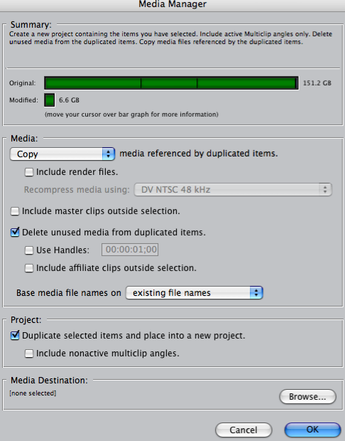

The FCP manual goes over this, but basically you want it to look like the attached image if your goal is to create a new project only containing the media you used in your finished piece. Just select the sequence you want, then right-click, then select media manage.
If you check the "Use Handles" box you can include a some "head & tail" on each shot. For example, selecting a handle length of 1 second will add 2 seconds (1 second at the beginning and 1 second at the end) to the duration of each clip you are media managing.
I personally don't recommend using "move" instead of "copy" because if something goes wonky while your data is being moved you could suffer data loss. Also, make sure every element in the project has a unique Reel number/name associated with it. FCP uses the Reel name/number and timecode to media manage the clips so if the Reel name/number is inaccurate or missing it can lead to problems.
After the project is media managed it will automatically open so just double check that everything copied over okay then you can delete the source files from your original project.
