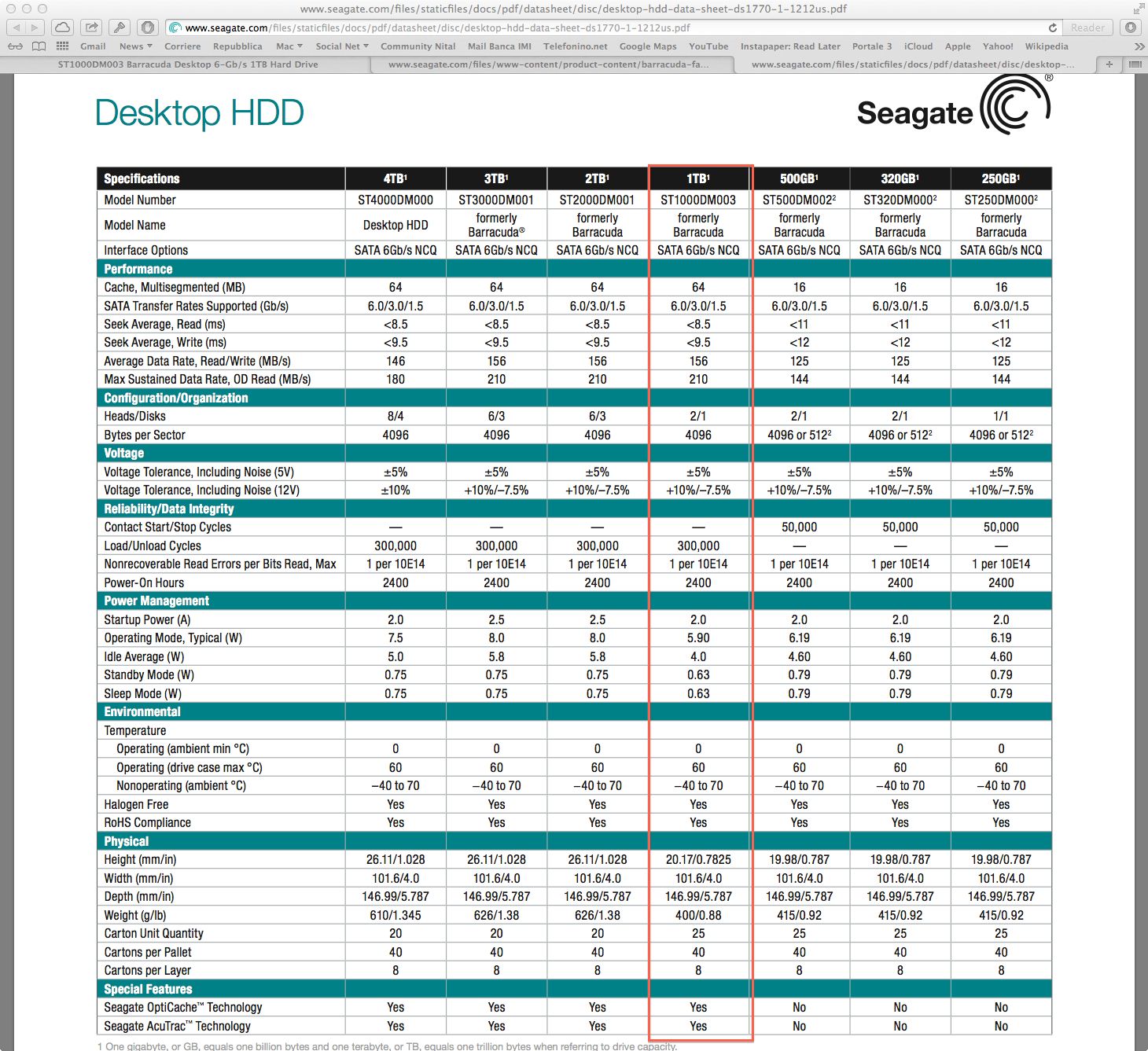

Here is the HDD inside my 27" (just arrived): I must say it seems to me very silent if compared to my previous 27" 2009 iMac 😛 (1TB FD)

I think that Western Digital will be more noise friendly than Seagate HDD. I hop to get mine with WD HDD.
