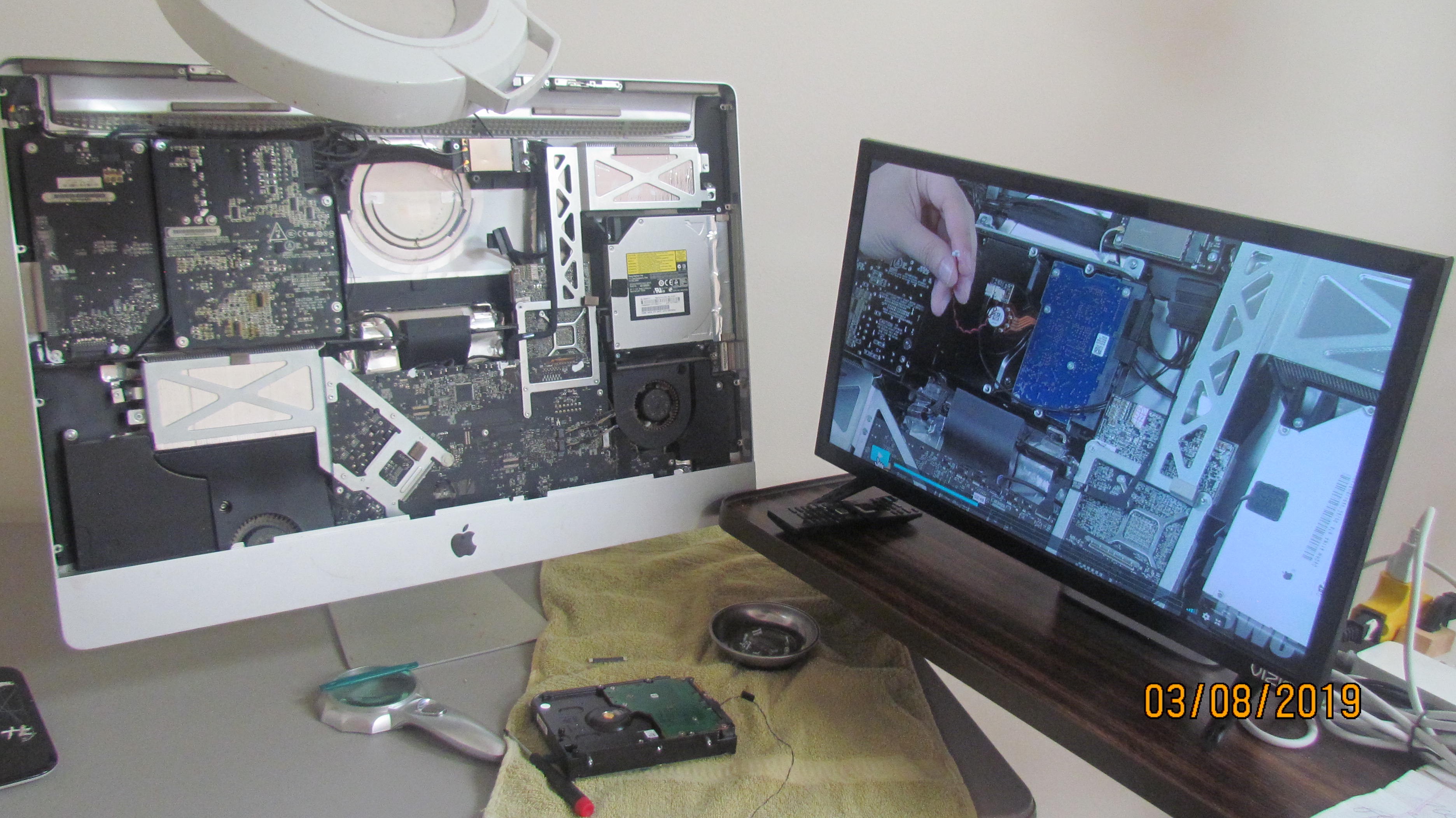

09 is DOA at Mac shop, they are calling possible HD fail. Either way cost to dig in exceeds value, so home it goes.
I was thinking if they were wrong, I would dig in and pull the HD and use it as back up. But, I have since gone all to Minis, so now I won't even start into it. Thanks again. a2

Changed mind and just dug in.
Got the box. HDD checked out OK ! Now have 1Tb back up drive. Thanks Much. a2

Flynnstone. Although Einstein was right, drive was (recall) replaced by Apple about 3 years ago. It is Barracuda 7200-12, old design, but very low time. It should work till I upgrade all my old stuff. Newest here now is still 2012.
I tore down the machine for the learning experience, as it was a probable CPU/GPU fail. (The shop call was HD... Wrong. LOL) A2
