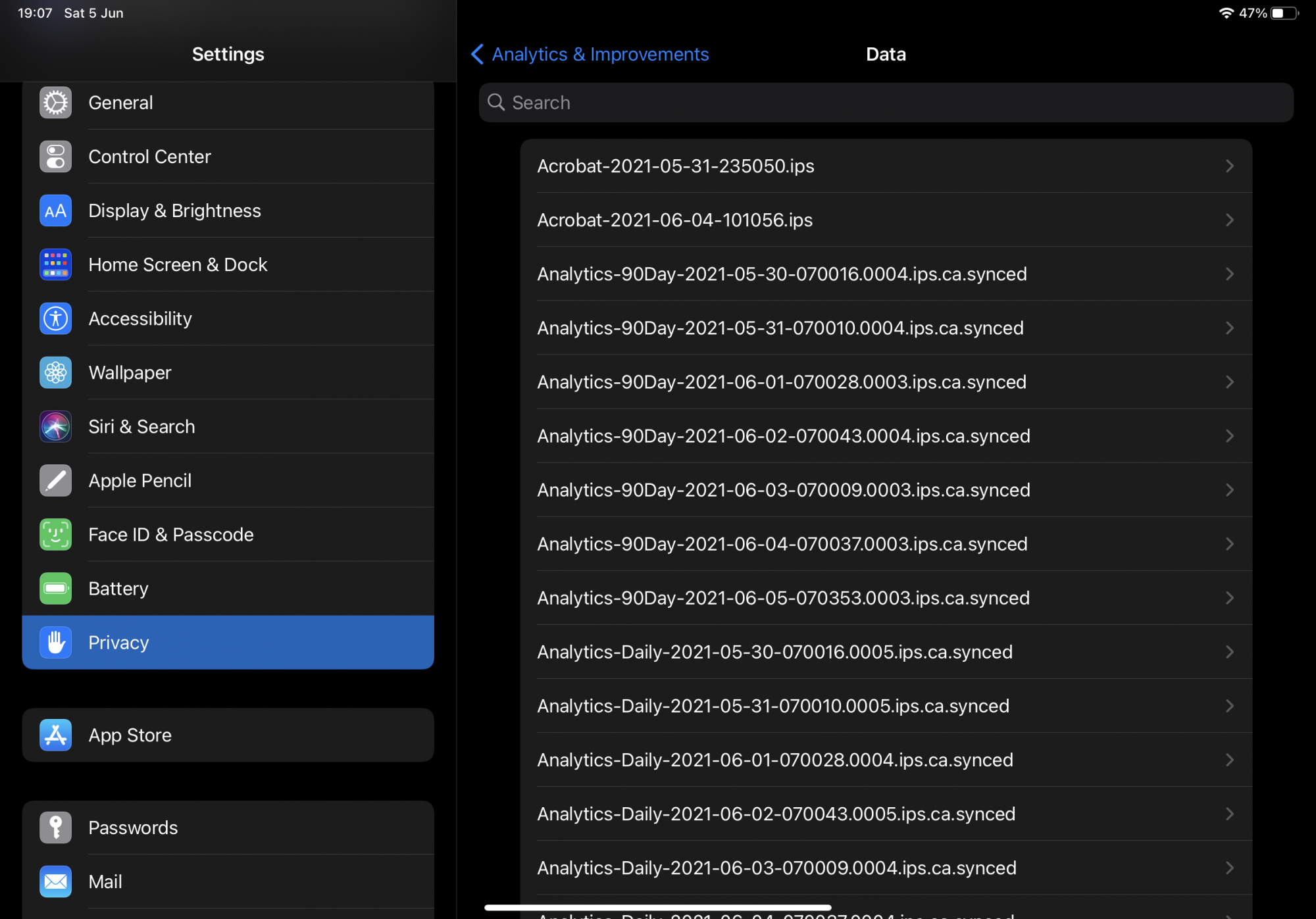

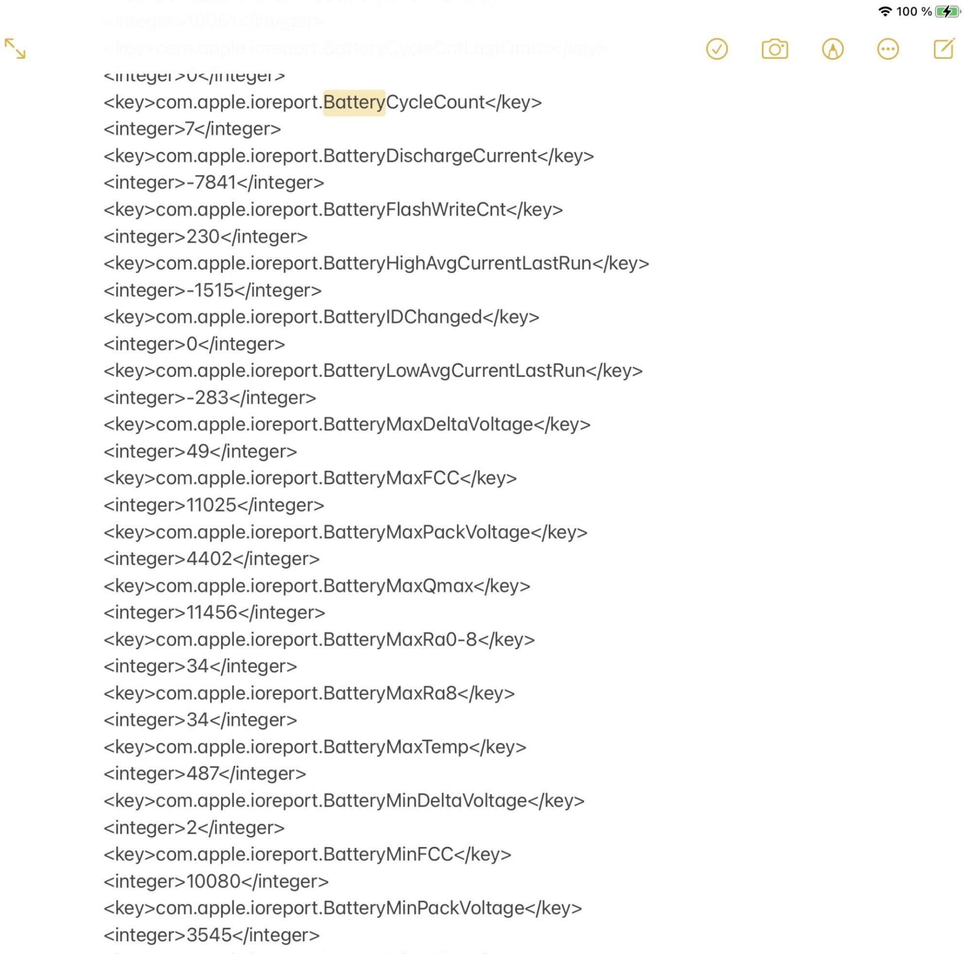

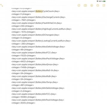

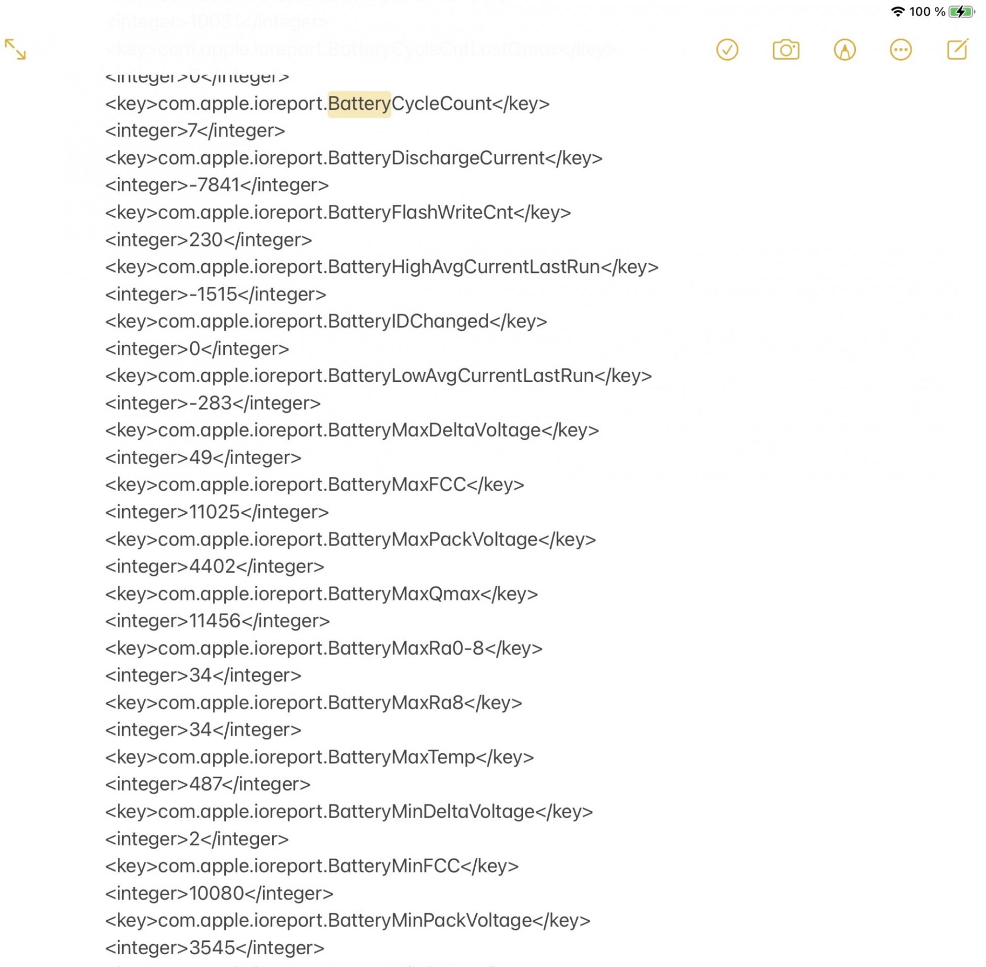

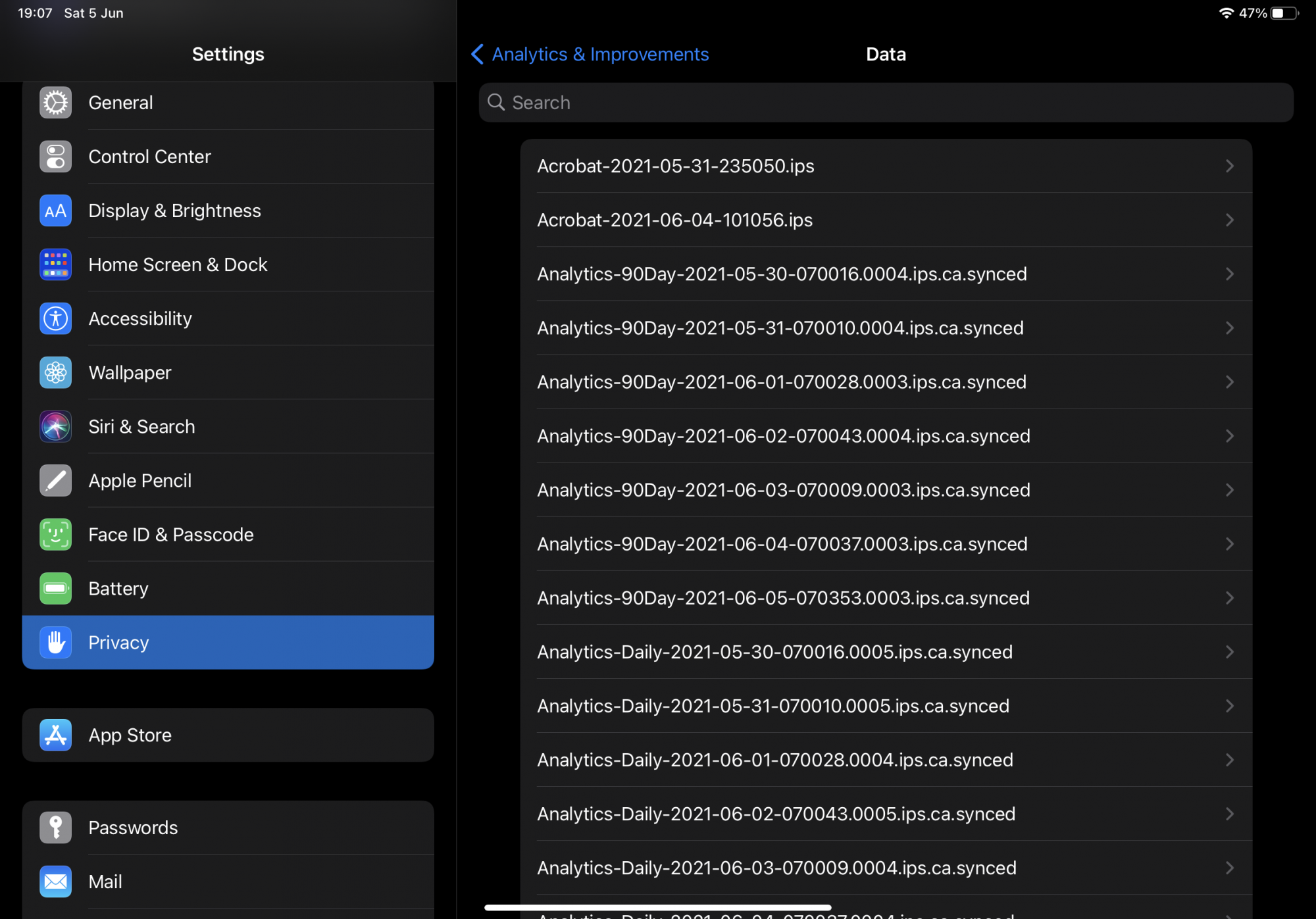

You have to turn share analytic data with apple on, then the file is generated every day. Copy & paste the whole text from the recent log-aggregated file to the notepad app and there is a search option.
i already copy the whole text and put then in microsoft word
but when i search for “battery” it found nothing
