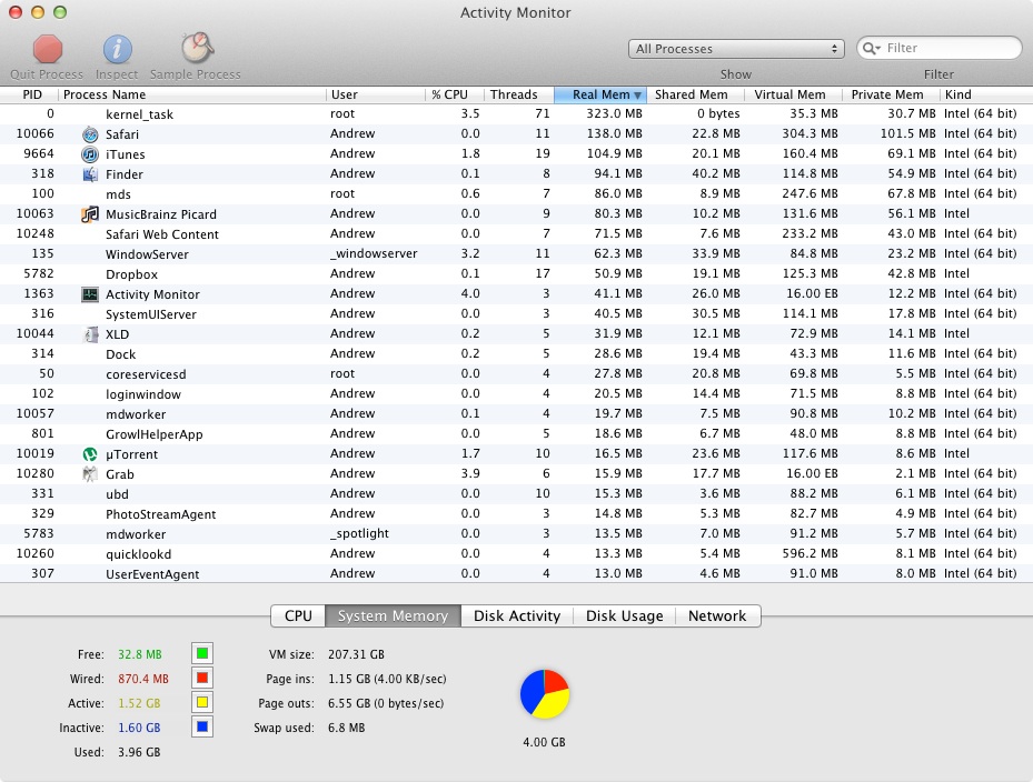

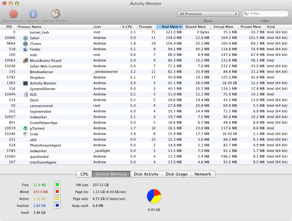

    1.6GB of inactive memory, yet I have 6GB of page outs. :rolleyes:

    So what? You're currently using not even 7MB of swap space.

    tkermit, look at the ratio of page outs to ins. That's not a healthy situation.

    How is it not ? Those stats are cumulative. We can't know what exactly went on with the whole memory situtation since his last reboot from 1 screen grab of activity monitor. If you pretend you can, you sir don't understand the concepts of memory management.
