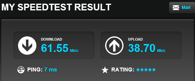

Its probably safe to assume you're not achieving gigabyte performance with your ISP. The best way to see what works best is to test it yourself.
Go to http://www.speedtest.net/ and run the test while on ethernet and then wifi and compare the results.
Here's my results (but I'm at work so its blazingly fast)

It all depends on the type of wifi and the how fast your internet connection is.
