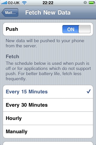

what are you on about... of course push (hence the name) is instant the 15, 30, hourly or manual options are for fetching data for apps or mail that doesnt yet support push... eg GoogleMail

For me with Textfree Lite there's about a 1.5 second delay between someone SMSing me and me getting the push alert. I'd say that's pretty darn near instant.
