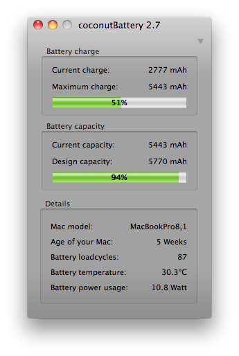

..and I've only had my MBP since April 25? I was shocked to see it has been that many. I basically live on my computer. It hasn't even been 2 months and I'm down to 94% of my original battery capacity. Screen shot:
My friend suggested that I take the battery out and use it plugged in, in order to preserve it. I opted not to, because I like to take it from room to room when I need to. But if this is what I'm dealing with, I'll gladly keep it stationary for long periods of time.
Do you suggest I remove the battery for a while?

I've had my MBP since November '09 and it's only gone through 57 cycles. I do use my MBP mostly at work and it's almost always plugged in. About once a month, I'll use it unplugged, drain the battery, and then fully charge it. My recommendation would be to plug your MBP in more when you can. If it's sitting on your desk, plug it in before using it.
For those who don't know, a "cycle" on a Li-Ion battery refers to the total number of charges that equal 100%. So, if you charge your MBP twice when it has a 50% battery left, that equals one "cycle". Or, if you charge your MBP ten times when it has 90% battery left, that is one "cycle". Or, if you charge it once when the battery is totally drained, that is one "cycle".

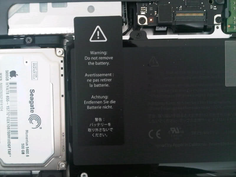

Out of curiosity, I removed my bottom cover for the first time to inspect the battery, but I am faced with this horrible sticker.
I don't get it.. does replacing the battery void the warranty or something? Or must it be replaced only by Apple?

At this time, I wouldn't be too concerned about the number of cycles you've already put on your battery. I think the total number of cycles a Li-Ion battery can sustain in its lifetime is around 1,000. So, at 87, you well under that.
There's no need to unplug when your MBP is charged. It's fine to run on AC power, as long as you don't do it all the time. Your battery needs to be used periodically to stay healthy. Also, your battery health will fluctuate over time. Calibrate your battery to make sure your readings are accurate. For replacement of a built-in battery, click the "Replacing the built-in battery in your MacBook Pro" in the following link.

Hah. I meant "87 battery cycles..in such a short amount of time." Which does seem to be way more than usual. But I'll live; I'll just do the minimum amount of cycling now.
