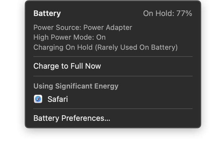

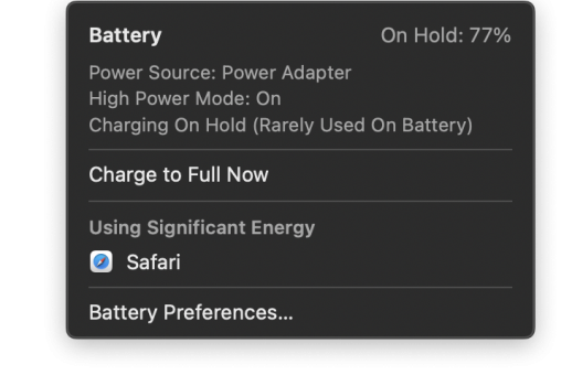

Keeping a battery at 100% all the time actually wears it down. However, if you keep it plugged in all the time MacOS will automatically manage the charge now, so it really doesn't make a difference.
That's interesting. Do you keep it plugged in all the time?
Interesting indeed!
I use my M1Pro MBP mostly in clamshell mode connected to an LG 4K UltraFine display that also charges the MBP. Usually, System Report > Power shows the battery near 100% and a cycle count of 2. Earlier today I checked and it said 77% and not charging. My first reaction was that the TB3 cable to the LG display had to be reseated, and yes that put charging mode back on.
Then I read your post, and from it I gather that macOS manages the cycle count by letting the battery draw down to 77% once in a while. If that is true then no more worries about being (nearly) always connected to charging power.😎
