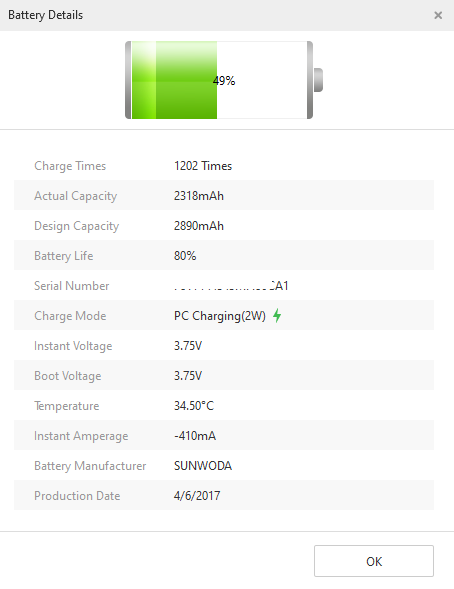

My mother is using the iPhone 7 Plus with the last iOS 14.
Interesting to note that my iPAD Pro 10.5 probably used less than the iPhone has 83% of battery life. But it doesn't drain the battery so fast as her device.

With 1202 charge cycles and battery life reduced to 80%, the battery in the 7 Plus has done a fine job, and is now ready for replacement.
Assuming you're in the US, Apple will replace the battery in the 7 Plus for $49. You can bring it in to an Apple store, or send it in to Apple, using a box they will supply.
