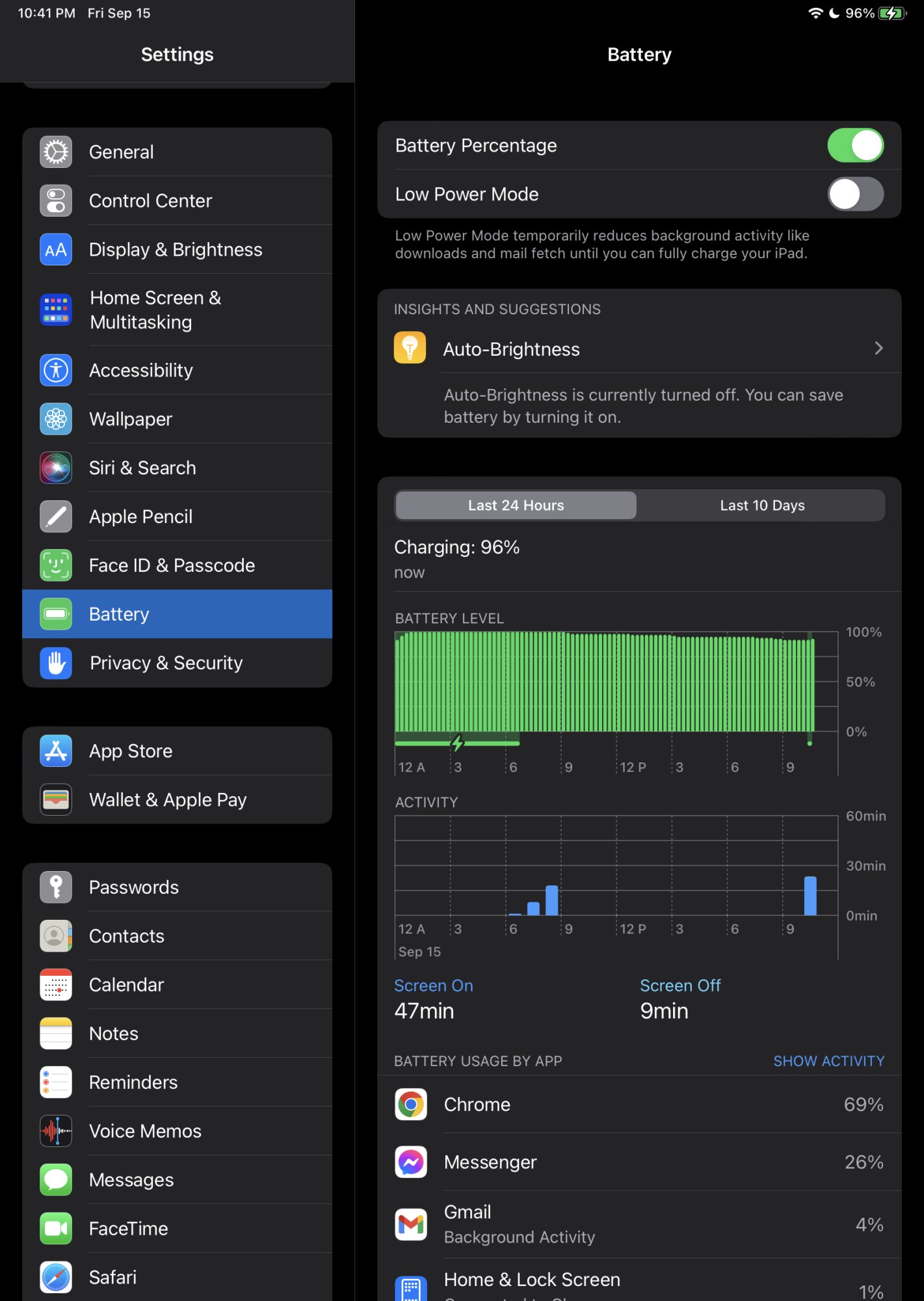

I have a 1.5 year old IPP 11” and the charging has become unbearable. I even upgraded to a 30 watt charger and no difference. I’ve tried different chargers, different cables and no difference. From my testing it takes 6 hours to charge from 90% to 100%. Sometimes it will get stuck at a number like say 95% then all of a sudden it jumps right to 100%. What the?
I don’t recall charging to be this bad when I first got the iPad. When I first got the iPad it was super fast.

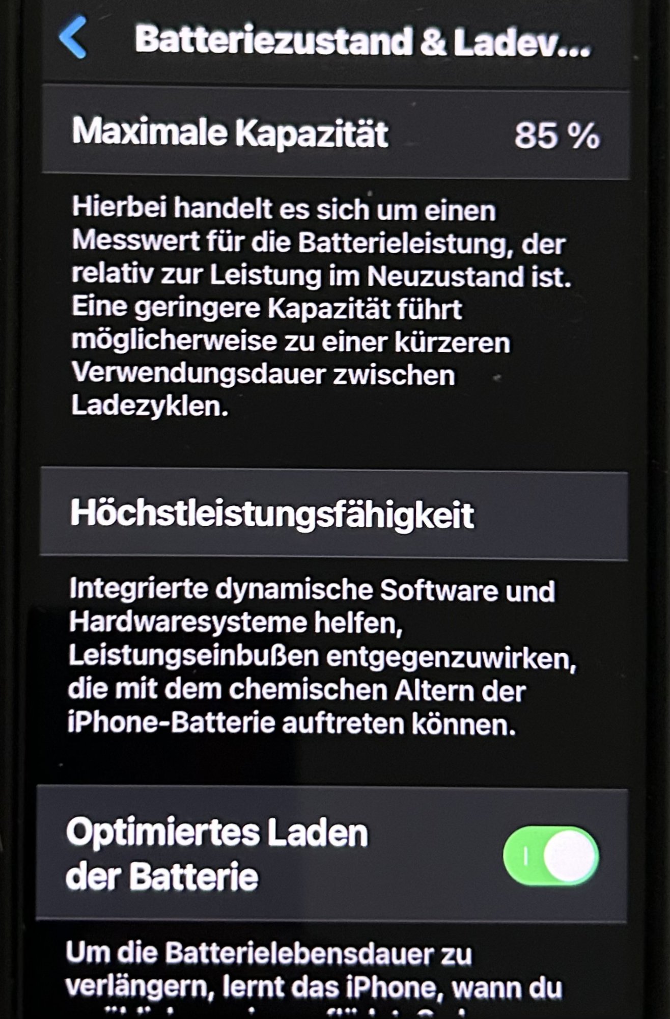

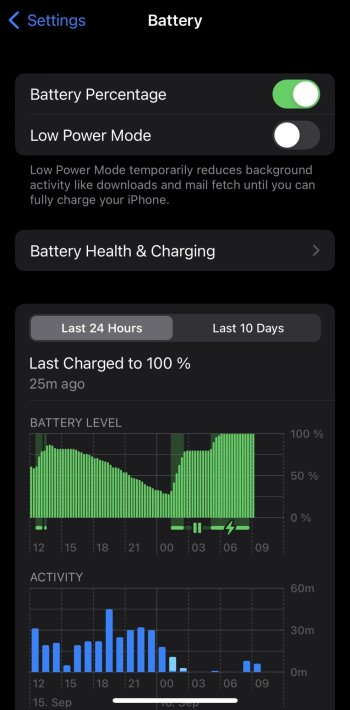

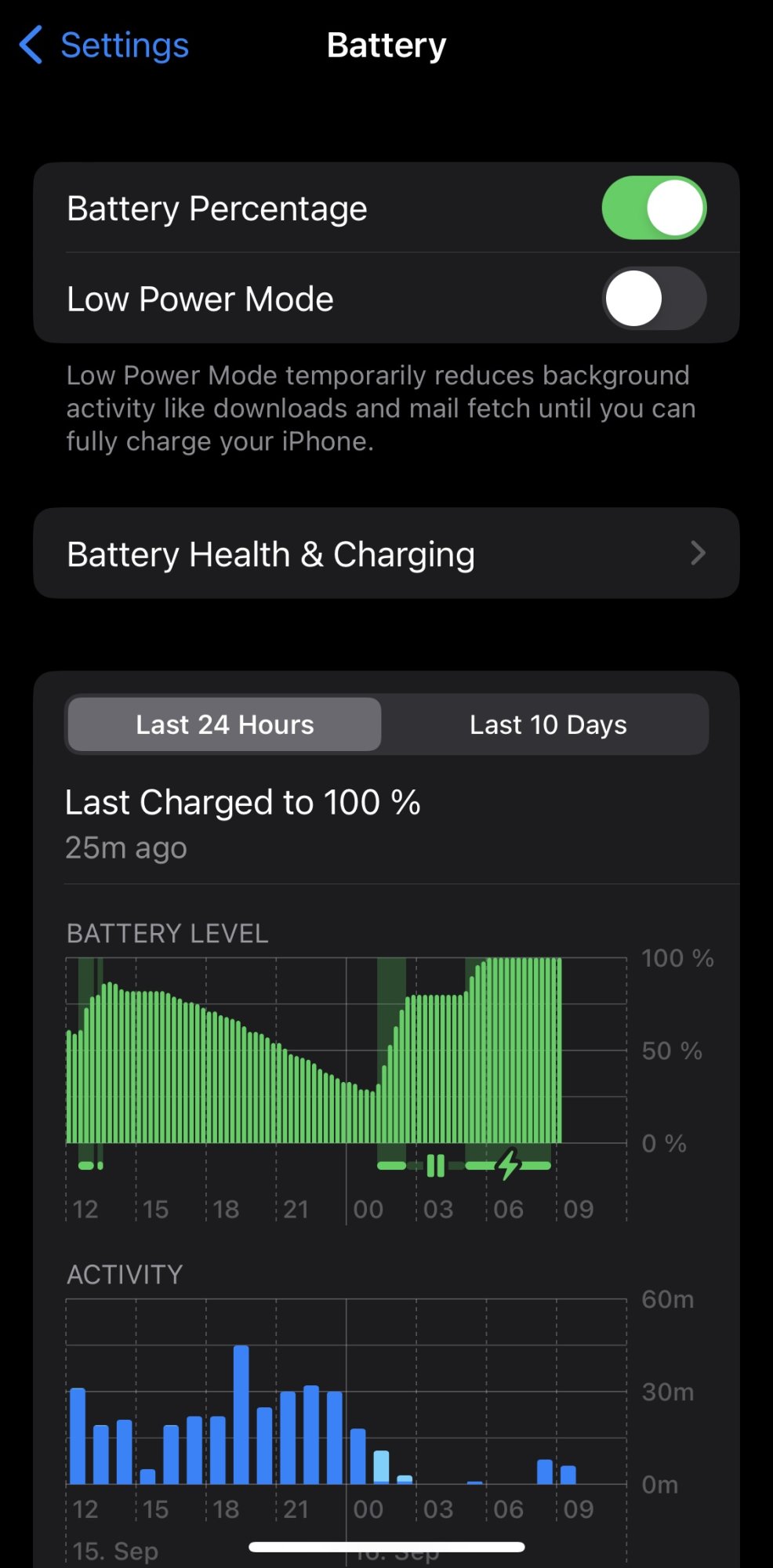

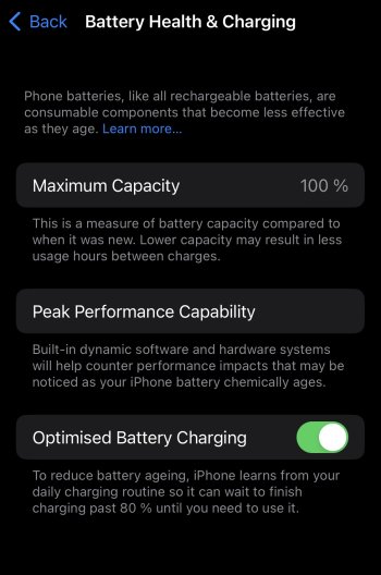

I guess you don't have it (Battery Health & Charging > Optimized Battery Charging). This is what it looks like under iOS:

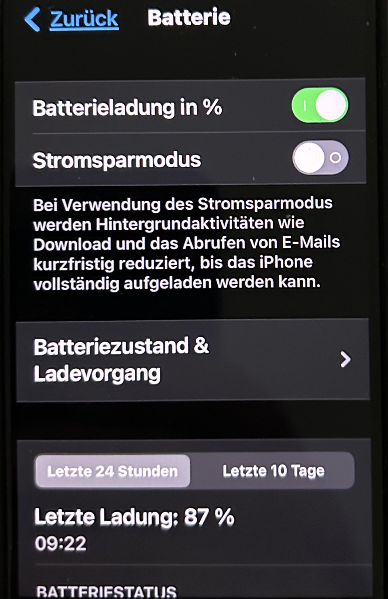

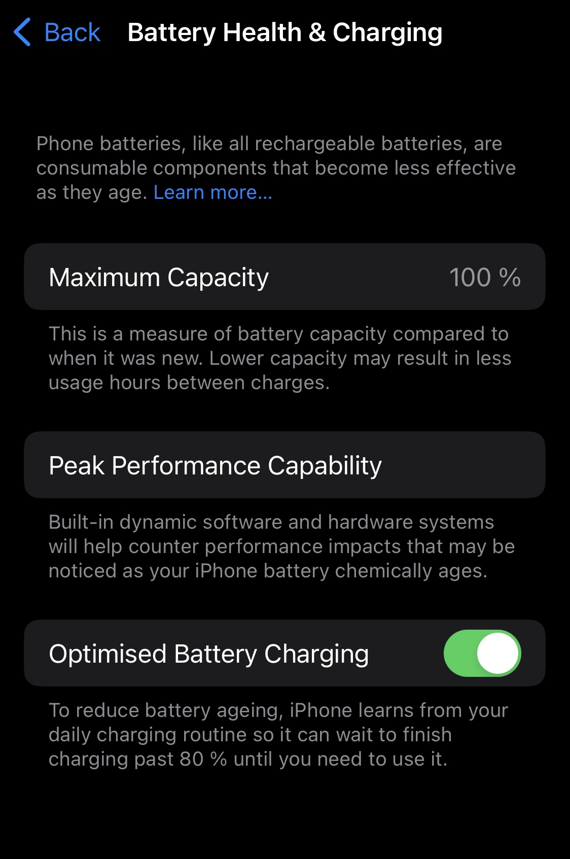

You have to go further on:
Click on „battery health and charging“
Than you might see the options I wrote about..

I'm not the OP, I just posted a screenshot from iOS of where Batteriezustand & Ladevorgand / Battery Health & Charging "should" be. For some reason the OP doesn't have "it" located between the Low Power Mode switch and Battery Level graph.

Well now I'm not so sure that my USB-C port in my iPad is defective. I think it still works because I have a 30-watt charger in my car I just plugged in my iPad to the car charger and it charged 15% in 15 minutes. So doing the math over 100% that would be 100 minutes, 1 hour 40mins which sounds about right.
But like I said I've tried two different chargers and two different USB-C cables at home. One 30 watt and one 65 watt charger with 100 watt USB cables and these are high quality chargers and cables. Even tried two different wall outlets at home and they all have the same issue with super slow charging.
