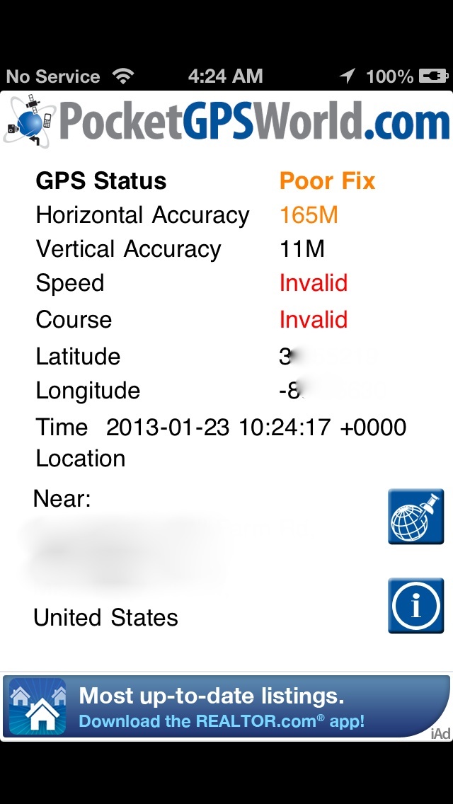

Using my iPhone indoors (with no cell or wifi signal) the GPS Status app reports satellite fix is poor and horizontal accuracy is 165 meters.

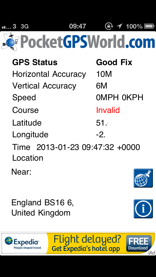

This is what I get indoors
I'm not next to a window and (quite unusually) the roof of the house is also covered in snow.
Perhaps I am getting a GLONASS signal - I don't really know enough about it to say whether it's better indoors or even if iOS lets Apps access the same sort of data from it.
I see you also have cell signal, and that could be why.
In the attached screenshot, I'm indoors with no service.
