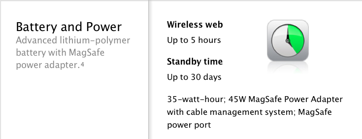

    The new MBAs are advertised at the Apple website with a standby of 30 days. So either something is preventing it from going into standby, or there is something wrong with your system.

    Yea but it also says 5 hours wireless web. I really don't know how they got 5 hours with this thing.
    I understand what you're saying though, I will see what happens tonight and then I'll contact Apple. Just so annoying since there are no Apple stores in my country, I'd have to send it to them and everything, right?
