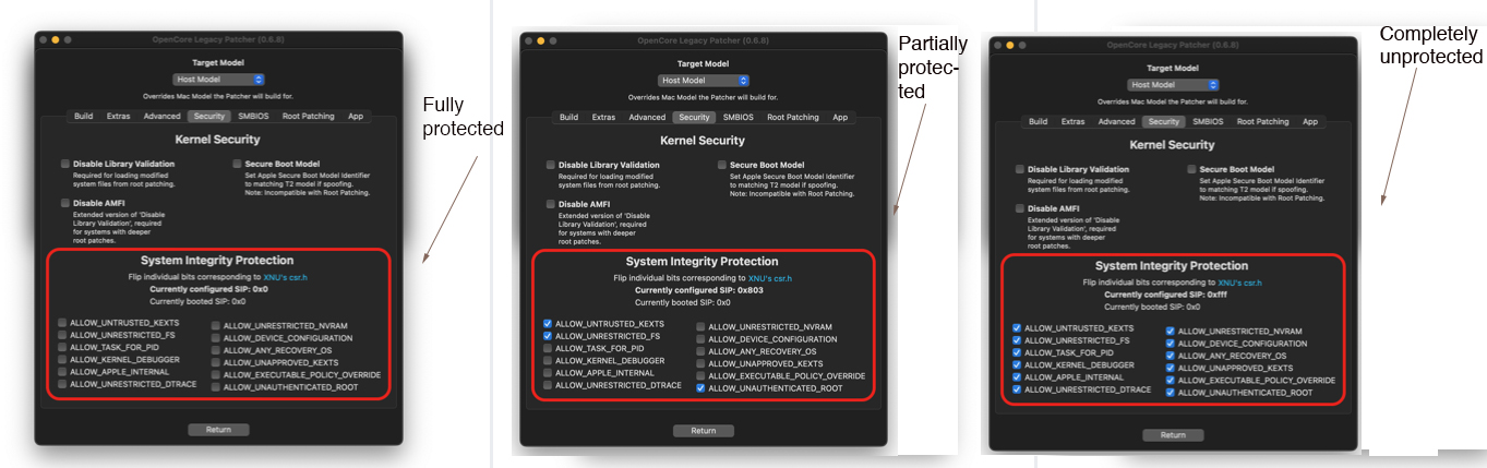

First of all, friends, I should state that my iMac type is 11,3 and not 14,1 — 14.4 as the prefix states (the system will not let me choose "iMac", as I have stated in another posting. My machine is a mid-2010 27-inch iMac.
My question is a simple one for anyone that knows his OCLP (Open Core Legacy Patcher). Using this valuable tool, I have installed Monterey a few times on two old machines of mine, with no problems. Not even for a tech-duffer like me!
However, I had a need to re-install Monterey on the SSD that has been fitted into the machine I am typing on. TTThis was because, although I could get Monterey to run OK, I could not get one particular app (XtraFinder) to work. I decided that perhaps SIP had not been disabled, so once again, I created an OCLP flash installer, and this time, before burning the final files to the flash drive, I ticked all the relevant settings (as shown in the far-right-hand image in the file I will upload).
Now, my question is this: would ticking all the boxes as shown, before finishing the creation of my flash installer, have caused this installer to have a problem in installing, or was it perfectly legitimate to tick those settings? After all, there must be a reason for the boxes to be there to be ticked. I am desperately trying to find out why the installer repeatedly says there is a probem/
With thanks in hopes of an informed reply,
C.H.

With regard to adjusting SIP before installing, I did try that (see the image, posted above), and the outcome was that the installer would not install. If this is done [B]after[/B] installing (I have also tried this), the settings do not stay. As you will know, OCLP is installed in the Applications folder, but this is only an alias of the real app, which is stored elsewhere. With neither, there is no means of saving altered security setttings, after one has made changes to them. When the app is closed, then opened again (to see what happened), they are seen to have reverted to how they were at first. If there is something one can do to save the changes and you told me, I would appreciate it.
