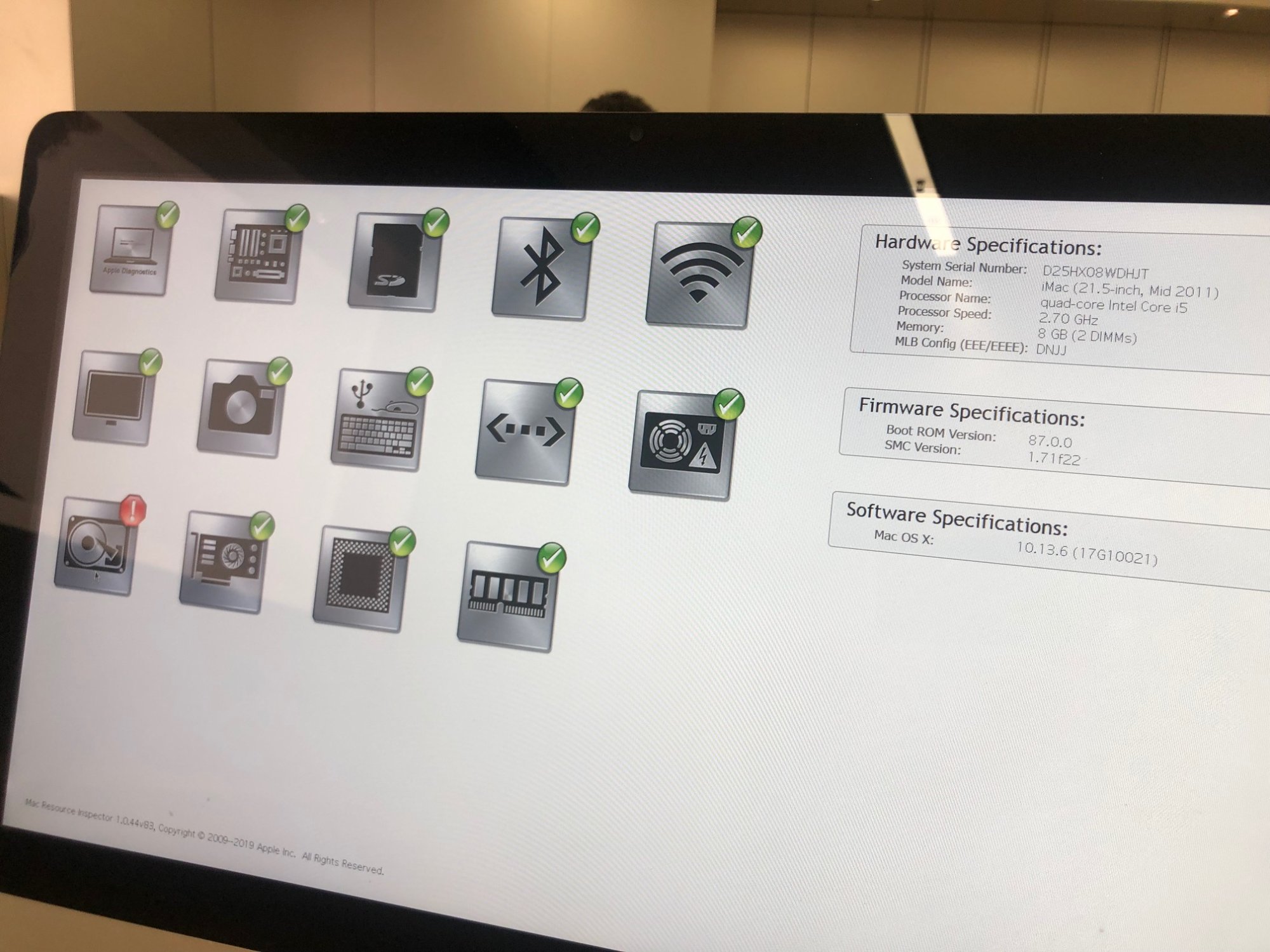

I'm new here and not sure if I'm even in the correct forum or in the correct post so please bear with me as I try to explain my problem. My 2011 iMac failed yesterday. It starts up, goes to a white page with the Apple logo then the horizontal bar goes to the half way point then the computer turns itself off. The day before all the web pages I select I had to wait for 3-5 minutes before they loaded. So I completely shut down the computer that night and the next morning I began having the problem as describe above. I made an appointment with the Genus bar and they scan the computer. I have a pic attached here as to what they found. What can I do to recover all my data or even if that can't be done. Hopefully, if anyone here can please give me some help it would be kindly appreciated. Please click on pic to enlarge.

HDD showing red, so your data’s likely toast. Hopefully you were backing up that 13-year-old computer regularly; if not then lesson learned.
Replacing the drive isn’t all that complicated but even so, there’s not much effort I’d put into reviving a Mac of that age.

2011 iMac?
The GPU may have gone bad.
Try this:
Power off (all the way off)
Put your finger on the shift key and KEEP HOLDING IT DOWN CONTINUOUSLY
Press the power on button and keep holding the shift key down.
This invokes a "safe boot", and (if it's a GPU failure), it should by-pass the discrete graphics and go to the CPU's built-in graphics instead.
Does this work?
Another thing to try:
Again, power all the way off.
Put your finger on the "T" key and KEEP HOLDING IT DOWN.
Press the power button and keep holding the T key down.
Do you get the "target disk mode" icon?
(computer won't "boot" in the traditional sense, you just see the icon)
Try BOTH of the above and post the results you get.
