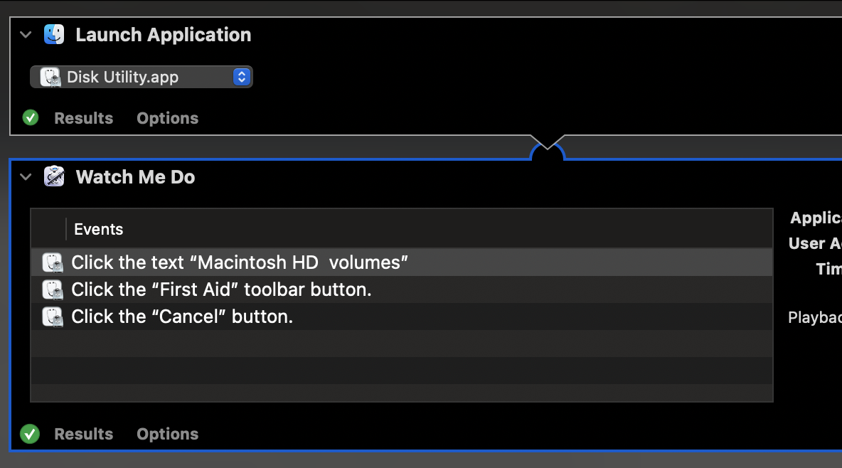

Yes, but personally, I wouldn't go this route: too many variables to reliably automate via recorder, I think. Eg. Names of volumes, encrypted or not (doing First Aid on an APFS drive with encrypted Time Machine on it seems to be really finicky re dismounting). Basically, probably would need an Automator workflow for each drive. But doable.
(Then again, I have not tried to automate this via Automator, I do it all via command line)

yes, all of the disks are mounting, show in DU, and can be repaired via DU, but have to be done one at a time. Sometimes one will not unmount and I have to quit a certain program that is running in the background, doing nothing btw (it is a download program, so I manually quit it and then the drive unmounts and disk utility proceeds normally).
I tried automator and YES! it is very finicky. "too many variables to reliably automate via recorder, I think." Absolutely, I thik so also.
